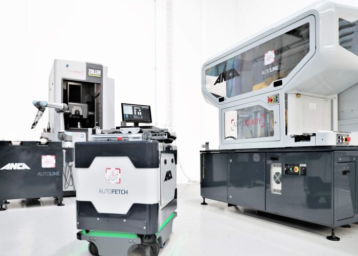

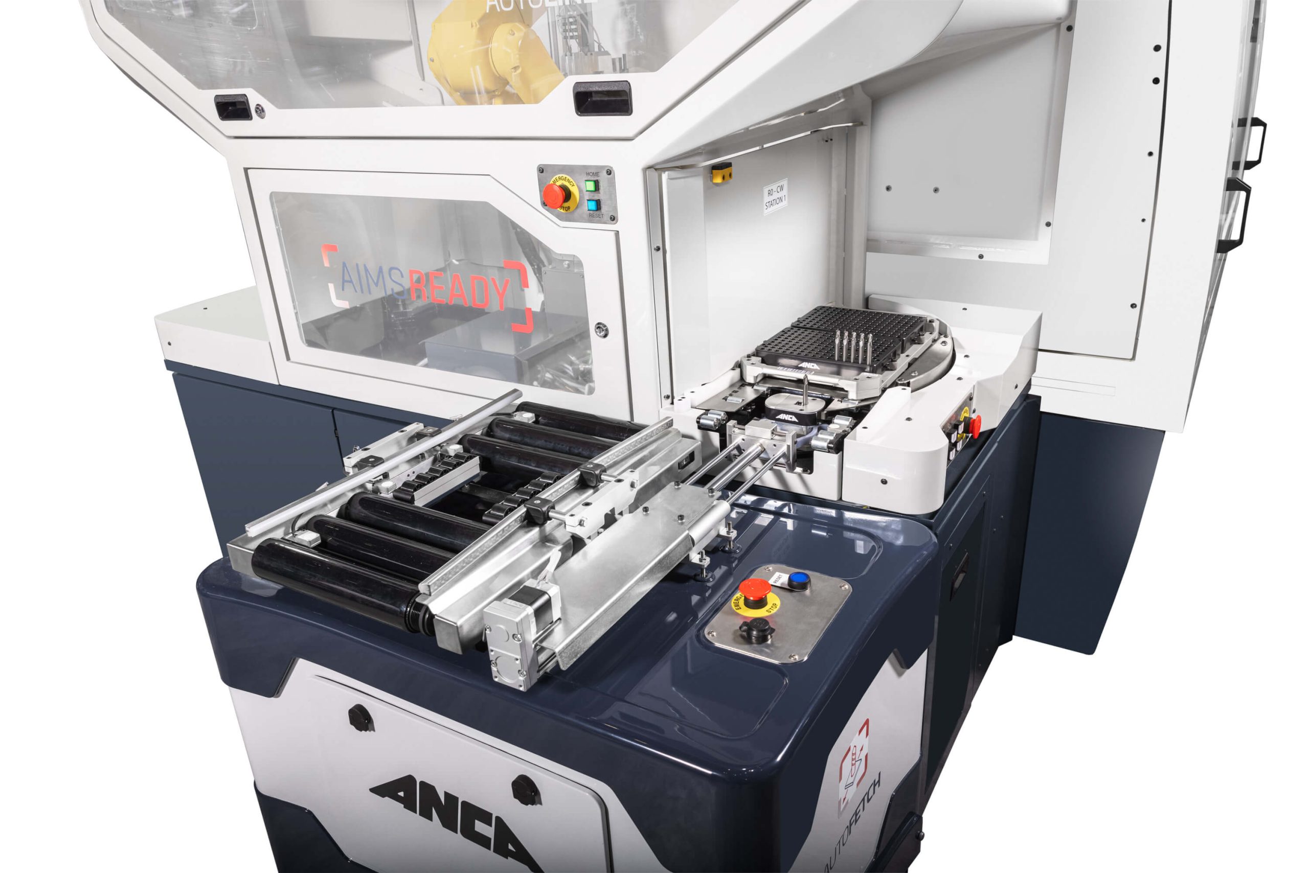

One of the most noticeable components of a fully automated AIMS cell is AutoFetch – the AMR robot responsible for transferring pallets between the setting station called AutoSet, to the tool grinder. It also automatically transfers single tools for spot-check measurements outside of the grinder. As you can imagine, there’s a lot of traffic and the AutoFetch can get very busy. An AIMS cell is typically configured within a footprint of the existing factory with adjoining areas where standard, manual operations are taking place. This is a great flexibility feature but also raises many questions about how autonomous operation can function alongside the traditional production plant with frequent foot traffic.

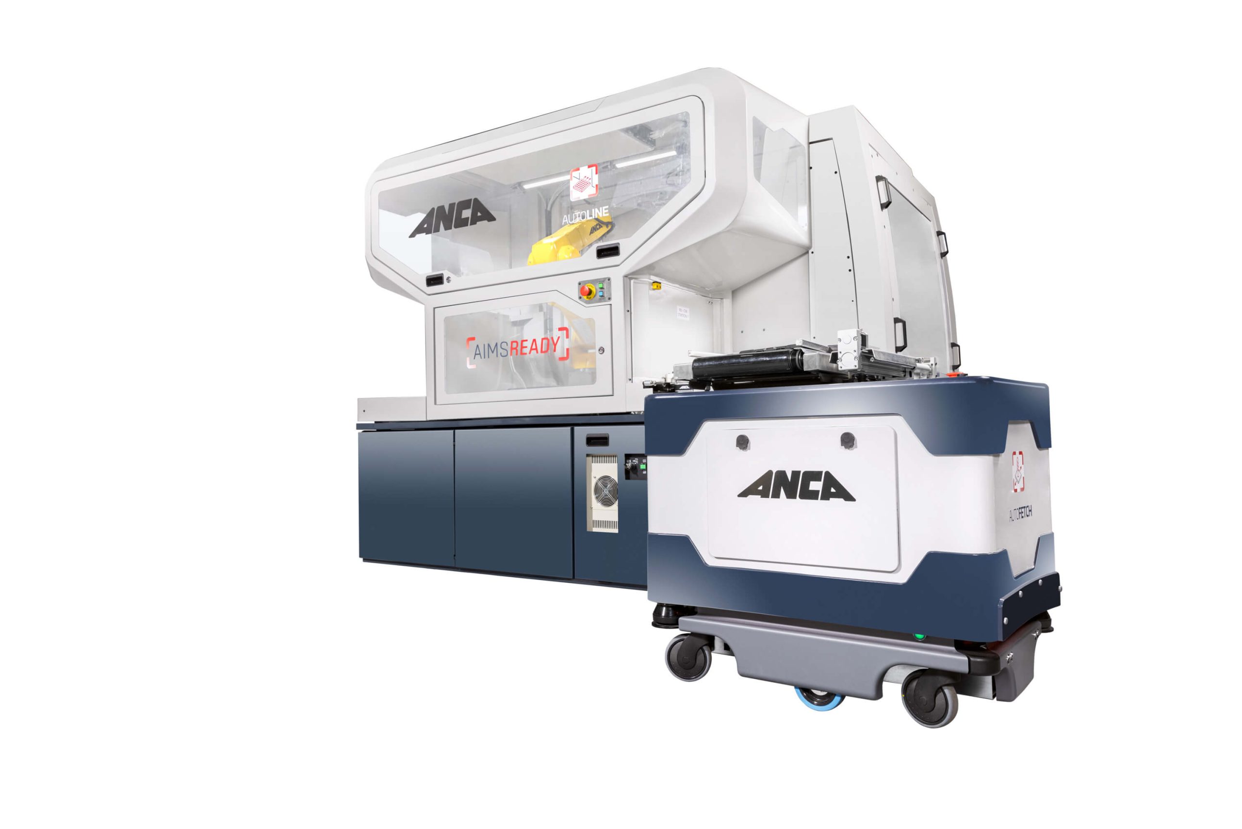

There’s no need to fence off the AIMS area thanks to the unique technology used with the AutoFetch robot. There are generally two types of automatic vehicles used on the factory floor – AGV and AMR.  AutoFetch is an AMR (Autonomous Mobile Robot) which is different to AGV (Automatic Guided Vehicle). The main difference is the way both units navigate their way around the factory. An AGV always follows a predetermined route which is defined by using various guiding aids like strips embedded in the floor, or reflectors fitted to the walls around the route. The AMR on the other hand, travels from one location to another using its array of sensors and initially scanned map of the area. It doesn’t require any additional infrastructure to transfer material from A to B. You just scan and map the relevant area during AutoFetch setup, mark the load and unload positions and then the robot, using sophisticated algorithms, will find the optimal way from one point to the other.
Autonomous material transfer with AutoFetch – safety implications
One of the most common questions we’re being asked is related to the safety of the AutoFetch. This is understandable since AutoFetch operates alongside personnel in the factory. The good news is the AutoFetch AMR is designed to safely operate in a factory environment where people are present.  The AMR moves from one station to another using an optimized route, and it constantly scans the immediate area for unexpected objects.  When an object is detected, the AutoFetch will stop and navigate around it.  An array of sensors – laser scanners, 3D cameras and proximity sensors – are used for this purpose. For extra security, an AMR prohibited area could be defined on the map to exclude autonomous traffic altogether.  In addition, the AutoFetch could be programmed to reduce speed in certain areas and warn nearby staff with audio warnings such as beeper, horns, or pre-recorded spoken messages.
