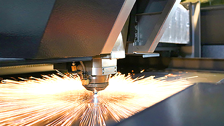

“For metal-based 3D printing, the industry mainly uses fiber lasers with a wavelength of 1,070 nanometers, which is in the infrared range, whereas a continuous-wave, solid-state fiber or disk laser with a wavelength in the range of 1,030 to 1,080 nm is typically used for cutting,” explained Dave Locke, sales specialist for additive manufacturing at TRUMPF Inc., Farmington, Conn.
Clearly the wavelengths are similar, but that’s not the case with wattages. The lasers installed in TRUMPF’s metal powder-bed-fusion (PBF) printers max out at 500 watts. Those used in the company’s lineup of lasers for cutting, conversely, generate up to 6 kilowatts—12 times the output. If that kind of laser power were placed in a 3D printer, it would burn a hole through the bottom of the machine.
It’s important to recognize, though, that laser power is only one operating parameter among many, regardless of whether metal is being fused together or ripped apart. Besides power, builders also strive to offer versatility. They go to great lengths, for example, to make their products “tunable” (adjustable to accommodate a range of materials), based on the alloy and thickness of the material being cut. TRUMPF’s BrightLine and CoolLine brands are tunable, as is Buena Park, Calif.-based competitor Amada America Inc.’s Ensis technology.
How lasers for 3D printing differ from cutting lasers

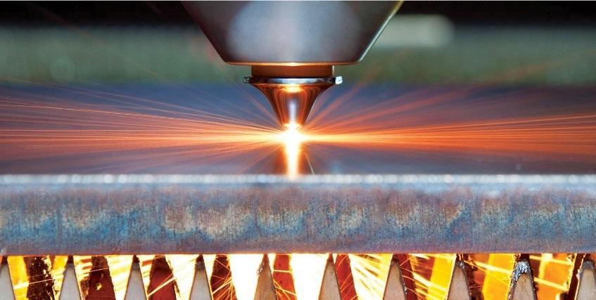

Fiber lasers, like the one shown from Amada, are now able to efficiently cut the thicker materials once reserved for CO2 lasers.
“A bell-shaped Gaussian waveform like that generated by fiber lasers provides a very high spot density and is what gives them the ability to rip through thinner-gauge materials,” explained Dustin Diehl, laser division product manager at Amada America. “This small spot size becomes less effective when you get into materials 1/2 in. and above, however, and it is the reason why CO2 lasers have long offered better speeds and higher edge quality in thicker materials.
“But as the technology has evolved, Amada (and others) has found ways to adjust the laser’s beam diameter and waveform to create a larger spot—one shaped more like a top hat. This, among other reasons, is why Amada has switched entirely to fiber for its standard lineup of laser cutting machines,” said Diehl.

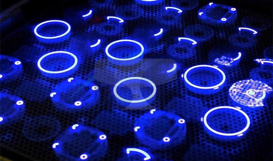

A bed of parts is being 3D-printed on an SLA from 3D Systems, the inventor of the stereolithography system.
The SLS machine just discussed has a fixed beam size, but Cullen said that stereolithography (SLA)—the technology on which his company was founded—now offers two spot sizes.
“By tweaking the crystal orientation in the Nd:YAG laser, we can generate a big spot for rapidly scanning large areas on the inside of the part, and then dynamically switch to a small spot for fine features and for tracing the outline,” he said. “The result is better part quality and faster build speeds.”

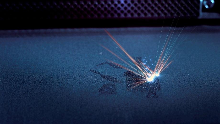

Ankit Saharan, manager of applications development and research and development at EOS, agreed with the importance of controlling spot size, but added that there’s far more to the additive laser story than the size of the spot and the wavelength or type of laser used to create it.
“A small spot size is better than a larger one, because the smaller the spot, the smaller the melt pool, [meaning] less stress in the workpiece,” said Saharan. “We start at around 45 µm on smaller platforms and go up to 100 µm for larger platforms.”
However, smaller spot sizes also mean lower deposition rates, so a balance must be maintained between process stability and cost. There are numerous other factors at play, too, like layer thickness, powder grain size, powder delivery and application mechanisms, reflectivity of the raw material, and assorted machine parameters.
Saharan said, “It’s a very complex scenario, and a high-quality laser—though important—is only part of what’s needed to create a stable [additive] process.”
