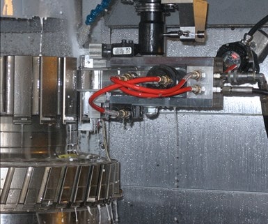

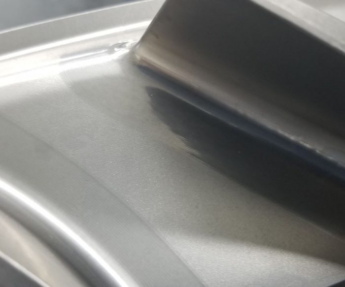

Low-plasticity burnishing is a finishing process developed by Lambda Technologies that strengthens a part at specific areas while minimizing the effect on the finish. In this example, the company strengthened the base of the turbine blades, which you can see in the shinier finish.

The company uses a suite of VMCs to both produce its burnishing tool and perform burnishing operations. According to Operations Manager Michael Prevéy, performing burnishing on five-axis machines enables Lambda to treat almost any part geometry.
LPB is a burnishing process in which the pressure applied to the workpiece using a hydrostatic roller-bearing tool of Lambda’s own design just exceeds the material’s yield point. The process requires extensive metallurgical knowledge in addition to precise control of burnishing tool positioning and pressure. Maintaining this expertise has enabled Lambda to significantly lengthen the working life of parts without significantly altering the shape or tolerance of the part. While not a new process, LPB has proven its effectiveness over recent years, even achieving Federal Aviation Administration (FAA) acceptance for repair and alteration of commerrcial aircraft components.

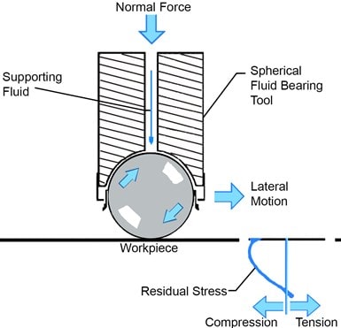

The burnishing tool envisioned that day at Disney is a hydrostatic roller burnisher design. Coolant is pumped through the machine tool’s spindle and into the tool to hold the roller bearing in place using an in-house hydraulic system and custom toolholder. The company says consistent pressure maintaining the position of the bearing enables the process to achieve high burnishing precision. After developing the LPB process, the elder Mr. Pevéy then formed a second division, Surface Enhancement Technologies, in order to implement it. Through this division, Lambda contracts with other companies to perform LPB operations on parts in addition to selling and leasing burnishing tools to those customers who have high enough part volumes to make dedicating a machine tool to burnishing economical.

Like other burnishing processes, LPB strengthens a part by compressing a layer of metal so that it resists fatigue, preventing cracks from forming deeper in the part. Thanks to the precision provided by the company’s hydrostatic roller-burnishing tool, it is able to apply just enough pressure to slightly exceed the yield point by an appropriate amount.
This diagram shows the hydrostatic roller-burnishing tool. This control enables the company to apply just enough pressure to just exceed the yield point at which the material deforms plastically.
By exercising this degree of control, the tool avoids breaking the material’s crystal lattices. This is important because broken crystal lattices, which can be caused by other surface treatment operations such as shot peening, can revert back to normal when exposed to high temperatures, losing the benefits of the surface treatment. Moreover, the burnishing tool is designed to work with any CNC-controlled machine, including robots, machining centers, lathes and even five-axis machine tools. This enables the company to strengthen parts with complex, contoured geometry at their weakest points.

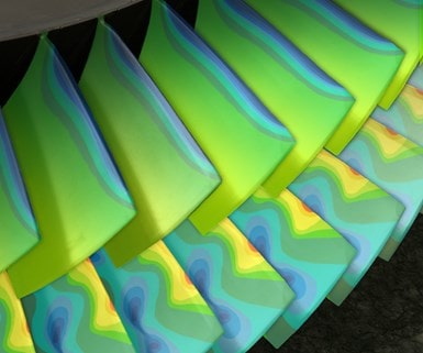

Every job Lambda takes on involves a complete analysis of the material and stresses. Pictured here is an FEA of a turbine, which enables the company to identify points of high stress.
To understand the stresses of the part, Lambda performs finite element analysis (FEA). “We perform a full scan and FEA of the part,” Mr. Prevéy says. “Using that, we can look at the magnitude and locations of part stresses to understand where burnishing will do the most good.” Going even further, Mr. Prevéy says the company can sculpt the stress patterns in the part, assisted by the multi-axis capabilities of the burnishing process. By mapping the stresses in three dimensions, the company says it can lengthen the life of many parts by a factor of 1,000.
