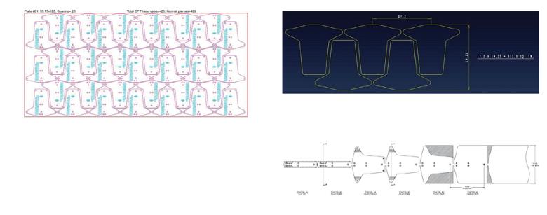

»Material utilization is a driver, especially when the material is costly. The first drawing shows excellent material utilization using nesting for laser cutting, with only a 1.84-lb./part scrap rate. The second drawing shows material utilization using stamping to blank the part. The third drawing shows the parts blanked and formed in a progressive stamping process. Images courtesy of General Stamping & Metalworks.
Axelberg said that the introduction of high-powered fiber lasers has had a big impact on the calculus unrelated to material type. As recently as five years ago, GSM was building pierce and trim dies to run sheared blanks in its stamping presses. In spite of all the manual handling, the process was still faster than cutting the parts on a laser. “We would run rectangular parts with square corners on our CNC punches because that was faster than laser cutting. Not so anymore. Now we reserve our punches for parts with 3D features that can’t be created on a laser, because the punches can’t begin to approach the profiling speed of the fiber lasers.”

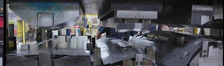

Haarsma concurred. “For example, stamping is the only process you can form a circular form on.” He added that some high-quantity parts will be run on a turret press because of their complexity.

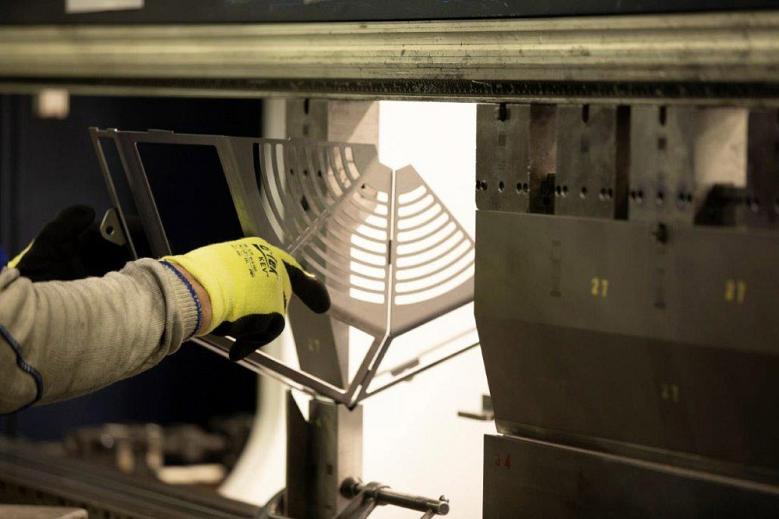

»This fan component is a good example of a part that must be fabricated on a laser and press brake, rather than stamped, because so much metal is removed and the remaining skeleton would become distorted. Photo courtesy of GSM.

Raw material utilization is another key decision-driver, Axelberg said. “Certain part geometries may leave a lot of scrap in a stamping die, but virtually none when nested with other parts on a laser.” Often the material cost savings justifies a higher processing cost, Axelberg said, adding, “That break point moves with the cost of steel.
“For example, a part was made from 8-gauge, Grade 50 galvanized. As production volumes started to climb, we hoped to transition it to a full progressive die. Unfortunately, the tooling payback was about 21/2 years because of the poor material utilization relative to the laser process. So we came up with a compromise. We built a two-out blank die to run coil, which matched the laser’s material yield with a big increase in throughput. The forming operation is still done in a two-stage form die in another stamping press.”
»Some parts with circular contours must be formed in a stamping press. Photo courtesy of Kapco.
