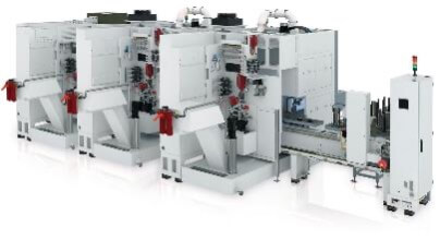

Pucktechnik in Solbiate Arno near Milan relies on automated manufacturing systems from EMAG.
The company Pucktechnik in Solbiate Arno near Milan, Italy, shows how this can be illustrated in concrete terms. The contract manufacturer was founded in 2017 and currently produces casting tools and various components. In total, the company has nearly 30 machines – including eleven EMAG VL Turning machines and a K 160 LA Hobbing machine from EMAG Koepfer.  These EMAG solutions provide high-volume and automated series production. Primarily with the help of these EMAG machines, around 650,000 Wheels and Wheel Hubs for earth moving equipment are currently produced by Pucktechnik each year. What is interesting here is that four independent production lines with a high degree of automation are used. The machines in each line are completely interlinked via TrackMotion, also from EMAG, with various operations running directly one after the other. As a result, the quantities produced in this area have increased massively in just a few years.  Their success is based on a typical EMAG approach: Vertical machining, assuring the highest possible productivity in the smallest (possible) footprint. This is what the VL machines, used here in combination with TrackMotion automation exemplifies. The basic technological principle of the lines is always the same (regardless of the specific machine type):

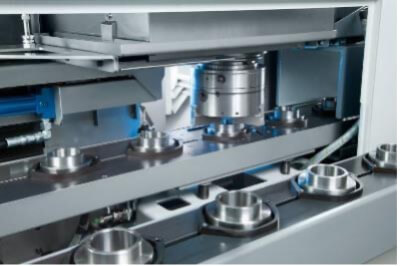

In the TrackMotion automation system, a so-called TransLift unit travels through the machines on a rail system (hence the name “Track”)
  • The TransLift – a lift-and-turn carriage on the TrackMotion line gantry with programmable electric gripper – picks up the raw-parts from a parts store, transports them to the machine at a speed of up to 150 meters per minute and deposits them on the machine’s internal shuttle.
The TransLift not only provides part transport; it can also turn the workpiece and is equipped with a Z-axis that allows a stroke of up to 650 mm.
  • Thanks to the vertical arrangement of the spindle, it can pick up the part from the pick-up position of the shuttle and guide it into the working area of the machine.
  • After machining, the workpiece is discharged from the machine via the shuttle and transported to the next machine or the discharge conveyor using the TrackMotion system. If necessary, the TransLift can also turn the component.
In the EMAG machine, the pick-up spindle takes over and feeds the component to the machining process.

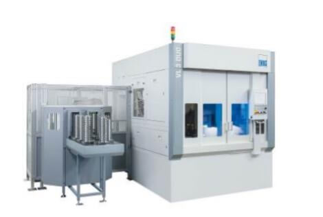

The VL 3 DUO is one of the most compact manufacturing systems on the market. Here in combination with parts storage and TrackMotion automation system.
On this basis, a wide range of possibilities opens up with the various EMAG machine types. For example, a VL 3 DUO, which has two completely self-sufficient spindles in separate machining areas for OP 10 and OP 20, can be expanded into a powerful complete system. The TrackMotion automation system not only ensures fast parts transport between the parts storage and work areas, but also turns the components between OP 10 and OP 20. On the other hand, “large solutions” are also possible via TrackMotion – for the production of differential housings, for example. Four machines are used here: In OP 10 and OP 20, both sides of the housing are turned on a vertical VL 4 lathe. For machining the outside in OP 30, EMAG relies on the VT 4, which enables 4-axis machining of the complete outside in one setup. In OP 40, another vertical lathe is used, this time a VL 6.

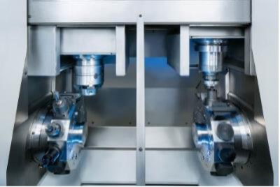

The two work areas of the VL 3 DUO are each equipped with a 12-station turret.

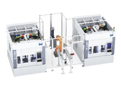

Robot cell from EMAG in combination with two VL 3 DUOs: The components are fed, for example, with infeed and outfeed conveyors, palletizers, drawers or by bin picking.
The requirements of the workpiece and the associated production process are also the focus of the developers of EMAG’s robot solutions. Critical questions are, for example, what batch sizes are to be produced in a given period of time and how autonomously is the solution to operate. At the same time, the connection of the machines based on pick-up technology is particularly simple. The robot places the part on a workpiece carrier on the machine shuttle, where the internal automation takes over as described. The components are fed into the robotic cell, for example, by infeed and outfeed conveyors, palletizers, drawers or by bin picking, with each solution having different strengths and basic conditions. The possibilities opened up by this approach are shown, for example, by the combination of two VL 3 DUOs with a robot: First, two components are simultaneously machined from one side in the first machine. Then the robot picks them up, turns them and feeds them to the machine for simultaneous machining of the second side, resulting overall in high output quantities in short periods of time. In addition, the cell can be easily adapted to other processes. The “truck drum brake” example is also interesting: here, four VL 8 machines are linked-up by means of a robot on an additional travel axis – a concept that combines the flexibility of a robot with the reach of a gantry.
