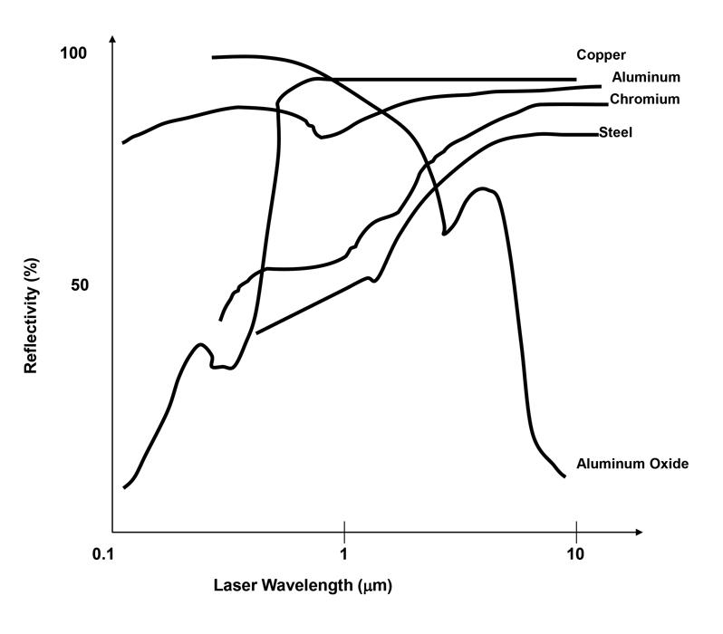

Laser cutting aluminum has never been a cakewalk, considering the material’s high thermal conductivity and optical reflectivity. But in many ways, the fiber laser has changed the game. Getty Images
Then at the beginning of this century, the fiber laser stepped into the fray with its 1-micron wavelength. Most common metals in the fab shop absorb more and reflect less of that 1-micron wavelength than the 10.6-micron wavelength. In the fiber laser arena, in fact, aluminum cuts very well, as do even copper and brass.

Surface reflectivity of metals at normal incidence and at room temperature (300 K) varies with the incident light beam’s wavelength. Source: Laser Cutting Guide for Manufacturing by Charles Caristan.

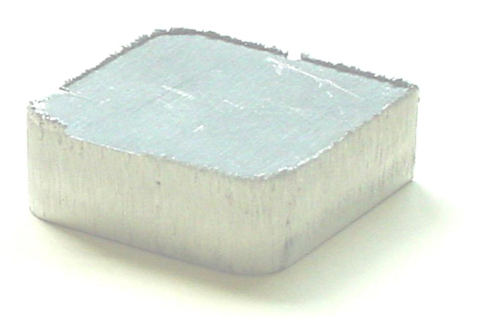

“The difficulty when cutting aluminum is to make a clean cut with minimal dross,” Caristan said. “With the proper assist gas, delivery, and flow, you can minimize the generation of dross.”
Viscosity plays a role here. All metal has a certain level of viscosity at melting temperature, but the viscosity isn’t constant as the metal heats further. The laser brings aluminum well past its melting temperature of a little more than 1,200 degrees F. As Caristan described in his book, aluminum’s viscosity actually reduces by more than half as its temperature rises between its melting temperature up to 1,328 degrees F—a difference of just a little more than 100 degrees F, a minute temperature change in the world of thermal cutting. As the low-viscosity material cools, its viscosity more than doubles as it gets closer to resolidifying—and evacuating it effectively before it solidifies becomes a complicated affair.
“Low viscosity becomes a major contributor to dross buildup,” Caristan stated, “particularly if the melting temperature of the material is relatively low, as with aluminum.”

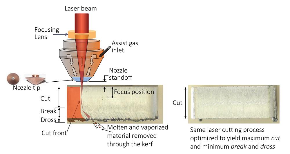

How laser cutting produces dross
Optimizing the focus, assist gas flow, and other parameters minimizes breakage and dross. Image courtesy of Air Liquide.
Traditionally, aluminum usually calls for a beam focus that’s deep under the surface of the material, particularly as the material gets thicker. This helps flush the material out the bottom of the kerf. To understand how and why this occurs, visualize material being melted at the top of the kerf, this time with the focus spot at or near the material surface.
“The material melts quickly and then flows through the kerf, where the beam diverges and the energy density drops quadratically,” Caristan said. Hence, less energy is available at the bottom of the kerf to the molten metal, making the metal oxides freeze into dross.
Set the focus low beneath the material’s surface and the power density situation changes. As the molten material from near the material surface travels down the kerf, it passes through the brightest section of the beam and, hence, remains a liquid until it is evacuated out the bottom.
The balancing act is just getting started. “There is a window of opportunity for the cutting speed,” Caristan said. “If you cut too quickly, you produce dross. But if you cut too slowly, you also produce dross.”
Dross from a fast cut is intuitive; the assist gas didn’t have time to flush the molten material before the heat source (the beam) moved forward, so the molten material “froze” at the bottom of the cut as dross.
But what about dross from cutting too slowly? Caristan said he doesn’t have hard science to back this up, “but I believe it has to do with the heat input on the metal and the ability of the assist gas to remove all the molten metal at once.”

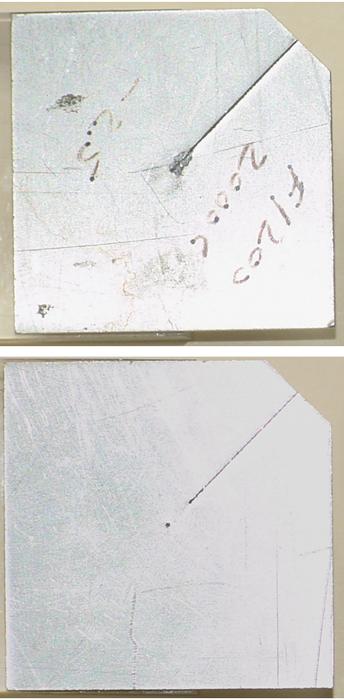

Laser cutting aluminum plate can have varying kerf widths
A varying kerf width can be an issue when cutting aluminum. In this example, the kerf is wide on the top surface (top image)and barely visible on the bottom.
Because gas flow is supersonic, laser cutting operators can’t eliminate the shock waves, but they can make them less detrimental to the cut by setting the nozzle standoff distance properly. “The rule of thumb is that the standoff distance should be equal to or less than the nozzle orifice diameter,” Caristan said. Go higher, and you exacerbate the shock wave deflections that could yield less gas to actually make it into the kerf.

Aluminum dross is soft
Aluminum dross is so soft it can often be combed away by the operator’s thumb.

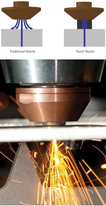

But again, energy from the beam is only half the equation; the effectiveness of the assist gas flow is the other half. Here nozzle technology has played an important role. Some nozzles now actually have components that touch the workpiece surface. These reduce the wasted assist gas that never makes it into the kerf, which is a particular issue with the narrower kerf produced by the fiber laser.
“In a typical nozzle, the gas flow expands as soon as it exits the orifice,” Caristan said, “and a big portion of it never sees the kerf. With these touch nozzles that kiss the workpiece surface, you have less gas wasted on the workpiece surface and more gas going directly into the kerf.”
