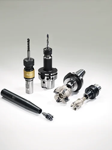

“When I see a tool with a Weldon flat, that usually signals that this tool is designed for aggressive milling,” he said. “That’s not to say you couldn’t use the tool for finishing, but the Weldon flat was added to the tool to prevent pullout. For roughing, the pin-lock collet is a good choice. For machining of 3D surfaces of a mold core or cavity, an Emuge FPC brand toolholder will deliver a high level of accuracy out of the box. With the balanceable holder, accuracy is increased without having to purchase a separate holder.”
