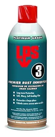

LPS 3
LPS 3 Premier Rust Inhibitor
Order Now
The LPS 3 is one of the best and most commonly used rust inhibitors in machine shops. It’s fairly cheap and will protect your clamps, vises, tables, etc. for up to two years. All you need to do is spray a light coating on your tool and then spread it around with a clean paper towel.

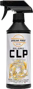

Break-Free
Break Free CLP Cleaner Lubricant and Preservative Gun Cleaner
 Order Now
Specifically created for firearms, this solution creates a thin film around metal surfaces that protects them from moisture and other contaminants. It’s perfect for cleaning, lubricating and protecting your tools from rust.

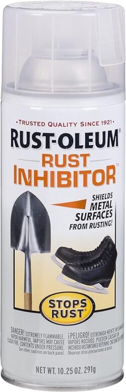

Rust-Oleum 224284 Stops Rust Inhibitor
Order Now
The Rust Oleum Inhibitor rapidly coats and inhibits rust. It even dries clean and quickly, leaving no tacky feel. This solution is non-corrosive, non-flammable and biodegradable.

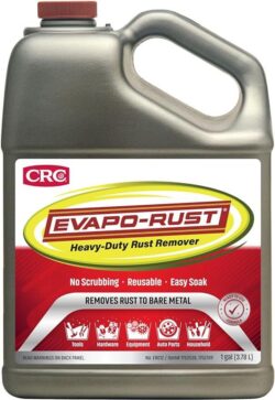

Evapo-Rust – The Super Non Toxic Rust Remover
ER012 Super Safe
Order Now
Evapo-Rust is definitely a fan favorite thanks to its reliability and reputation. Available in liquid or gel form, this product is specifically formulated to remove rust and requires no special equipment. All you have to do is soak your parts in the liquid formula or cover them in the gel, and let them sit for a few hours. Take a look at how Adam Booth (aka Abom79) uses it to clean rusted tap wrenches and C-clamps.

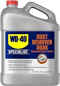

WD-40 – 300042 Specialist Rust Remover Soak
WD-40 Specialist Rust Remover Soak
Order Now
This non-toxic soak made with biodegradable ingredients helps make old metal look new again without scraping, chipping, or scrubbing. Especially great for rusted tools, this product is part of the WD-40 Specialist Line which is designed for industrial-strength quality and extreme penetration.

    I prefer “Heavy Coat Rust Preventive”, item #145220 from imscompany.com to LPS3. It dries faster and leaves a less gooey coating. It’s made for outdoor storage of injection molds, although I see on their website they also have tool steel protectant, rust inhibitor, rust remover etc. They’ve got all of the good stuff to keep precision metal finishes free from blemish.
