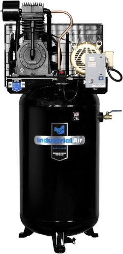

Industrial Air Cast Iron Air Compressor
Industrial Air IV7568075 Vertical 80 gallon Two Stage Cast Iron Industrial Air Compressor
Order Now
This air compressor has an integrated control panel for added control and convenience. The Industrial Air cast iron air compressor offers an expertly designed heavy duty, 7.5 HP motor that operates on 460 volts.

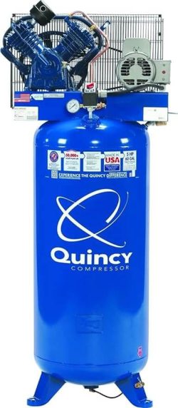

Quincy Reciprocating Air Compressor
Quincy QT-54 Splash Lubricated Reciprocating Air Compressor
Order Now
The Quincy reciprocating air compressor features an industrial-grade, US-made Baldor motor. This compressor is built for efficiency and lowers operating costs, producing more compressed air at a lower horsepower. This compressor also boasts a 30,000-hour pump life rating.

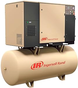

Ingersoll Rand Rotary Screw Compressor
Order Now
The technology in this rotary screw compressor allows it to operate for extended periods of time at very low temperatures, making it ideal for industrial applications. This compressor has a full sheet metal enclosure to manage noise.

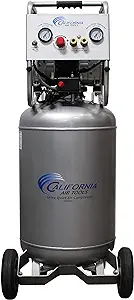

California Air Tools Ultra Quiet & Oil-Free Air Compressor
California Air Tools 20020 Ultra Quiet & Oil
Order Now
This oil-free air compressor is designed to be one of the quietest air compressors in the industry with 70 decibels of sound. The pump is designed to have a life cycle of 3,000+ hours. The two, no flat wheels and sturdy handle make moving this air compressor very easy. Designed for metalworkers looking for power, air flow and at least 30% less noise.
