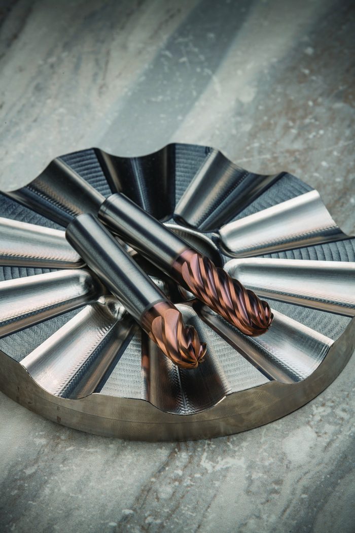

PART DONE, TOOLS LIKE NEW The POW-R-ARC 6-flute roughed this titanium 6AL-4V distributor disc at 3362 rpm, ½ x D axial depth. The part is 5½ in. dia. The POW-R-ARC 8-flute provided the finish at over 200 ipm. Cycle time = 13.5 min. end mills are still like new.

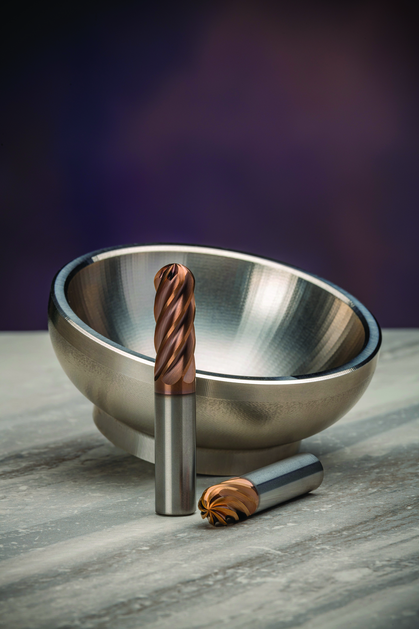

AMAZING LONG-LIFE TOOL Machining this Inconel 718 deflector bowl would take much longer with 4-flute mills. But the POW-R-ARC 8-flute did the 3D roughing and semi-finishing in 50 min. at 31 ipm. The same tool completed the finishing at 60.5 ipm and chamfering the rim in just 22 min. total cycle time. And it still has plenty of tool life!
