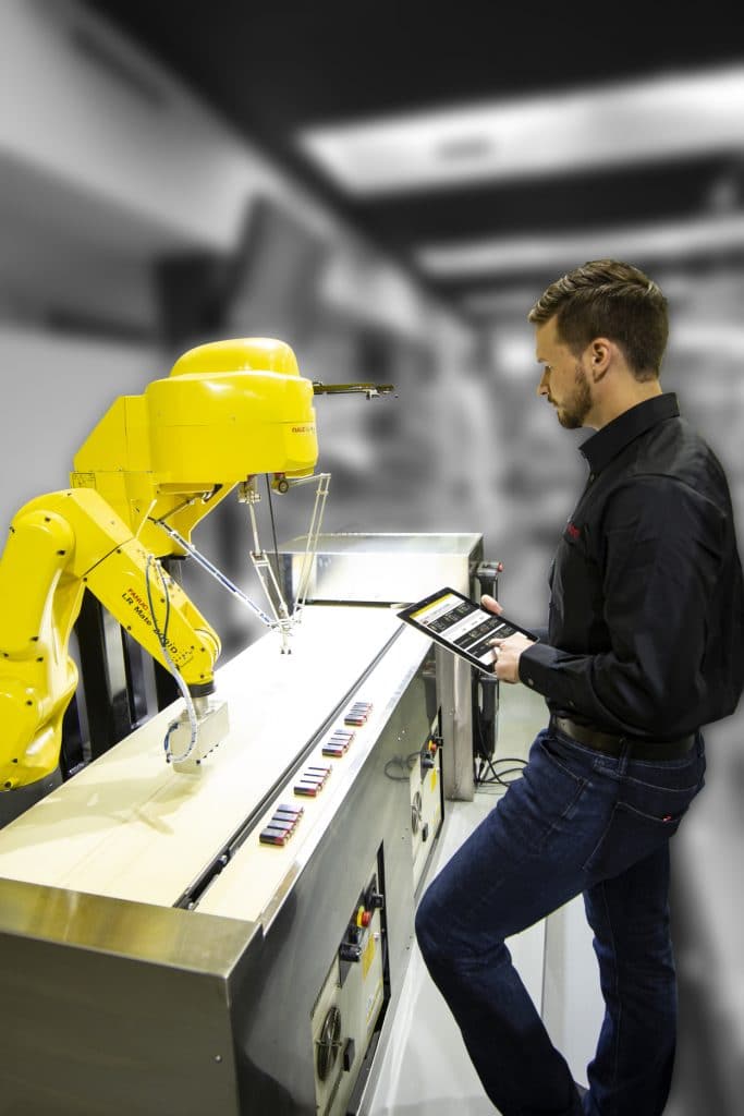

Launched in 2015, FANUC’s ZDT monitors robots remotely and reports information on a robot’s health, maintenance needs, and utilization rates. It does this automatically and while a company is running production, according to the company. Gazzarato reported that, to date, ZDT analytics have identified potential equipment issues and notified customers to take corrective actions to avoid unexpected downtime in over 600 cases, saving companies more than $75 million.
“But ZDT also does what we call condition-based maintenance,” Gazzarato said, “which goes one step beyond predictive maintenance. We look at the way a robot is being used and we can predict when maintenance should be performed.” This includes things like changing the grease on the drives or inspecting the cables that go on the arm. “For example, if the robot isn’t being used aggressively, you may be able to delay your maintenance routines. Conversely, if it’s being used aggressively, we may tell you to check the cables or the grease sooner,” he said.
FANUC’s Zero Down Time app tracks all of a company’s robots remotely to report on status and predict problems before they occur. (Provided by FANUC)
Note that “aggressive use” doesn’t just refer to hours of operation. ZDT also tracks things like peak torque on the robot’s drives and how much energy the robot is using. By combining data from multiple sensors, applications like ZDT can make judgments about machine condition, according to the company. In one recent example described by Gazzarato, ZDT identified a potential problem with a customer’s robotic weld gun based on measured peak torque and disturbance torque as the gun closed on each operation. It turned out to be a missing bolt holding an adapter to the jaw, he said.

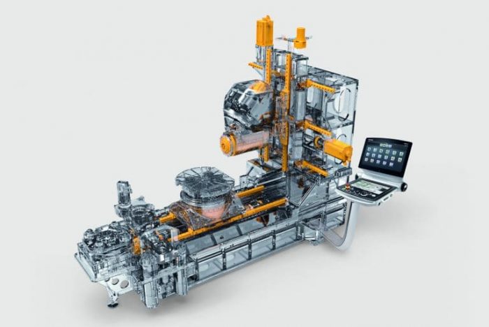

Likewise, adding sensors to the machine can pay off, and DMG Mori, Hoffman Estates, Illinois, has addressed this. Partnering with the Schaeffler Group, Troy, Mich., DMG Mori added 60 sensors to its DMC 80 FD duoBLOCK machining center to gain real-time knowledge about the machine’s performance.Once machines are connected and providing better insight into utilization rates, and perhaps tied to apps like ZDT or ACM, it’s time to “drill down to ask more detailed questions,” said Furtado. That can mean more apps, more sensors, connecting more machines, and expanding the scope of connections to more partners in the supply chain. Most of the data collected for the systems described so far comes from the digital feedback inherent in modern CNCs: things like the control knowing when the spindle is on, or the torque load on each drive. This digital feedback predates Industry 4.0, but connecting the data with outside resources like smart software increases its value.
For example, the linear guideways in the X and Y axes have acceleration sensors that measure vibrations to collect reference data and define trends, set tolerance thresholds, and control lubrication consumption. The ball screw nuts have axial and radial vibration sensors. Bearings for the linear axes have axial force sensors. The rotary table has sensors for temperature, vibration, and grease.
All this data feeds into DMG Mori’s CELOS Condition Analyzer app, which visualizes, analyzes, and predicts machine status well enough to schedule maintenance. It performs this function for individual machines, across a factory, or across geographically dispersed plants via the cloud. A separate app called Performance Monitor captures and analyzes overall system efficiency while taking into account machine availability and component quality, according to the company.
DMG Mori added 60 sensors to the components highlighted in orange on this DMC 80 FD duoBLOCK machining center in order to gain detailed, real-time knowledge about the machine’s performance. (Provided by DMG Mori)
