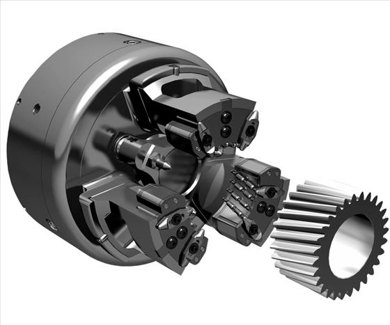

Royal Products expanding mandrel cross-section
Royal Products’ line of CNC expanding mandrels are useful for workholding applications that require access to the entire outer diameter of the workpiece. Lathe drawbar motion expands the mandrel sleeve to grip the part, and parallel sleeve expansion maintains full contact with the workpiece for high holding force and torque transmission.
