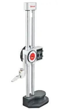

Starrett 3259-12 Stainless Steel Dual Post Dial Height Gage, 0-12″ Graduation Range, 0.001″ Graduation
ORDER NOW
The only dial height gage that made it on our list. The dual-beam provides increased movement, smoothness and stability for consistent measurements and the two separate digital counters can register upward and downward travel. Although less accurate (0.001” graduation) than its electronic counterparts, this is a solid and accurate model.
