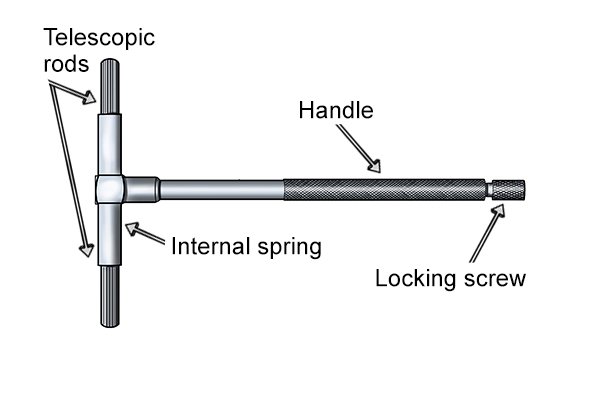

Telescoping gauges, commonly referred to as snap gauges or telescoping bore gauges, are indirect measuring devices used to measure the internal diameter of a bore, hole, groove, slot, etc. This T-shaped tool consists of a handle, two telescopic rods and a locking screw.
telescopic gauge
Image Credit: wonkeedonkeetools.co.uk
There are two styles of telescopic gauges. One type has two plunging telescopic rods. The other type only has one plunging rod, the second rod remains fixed. The telescopic rods are what measure the distance of the bore, with the help of a micrometer. The ends of the rod are the shape of a half ball, called the radius edge. It’s this shape that’s responsible for the telescopic gauge’s accuracy.

1. Collapse both the measuring heads by rotating the locking screw anticlockwise.
2. Place the gauge into the bore with one head held in place against the wall of the bore. Begin to loosen the screw, but not too much because the rods are spring loaded.
3.Proceed to tilt the gauge so the rods are slightly inclined and tighten the locking screw.
4. Whichever end you lifted a bit above horizontal, force it slowly downward through the bore. As you do this, wiggle the gauge back and forth. This will allow the gauge to find its smallest size on the spring.
5. You are now ready to measure with a calibrated micrometer, since there is no scale on the tool itself.
