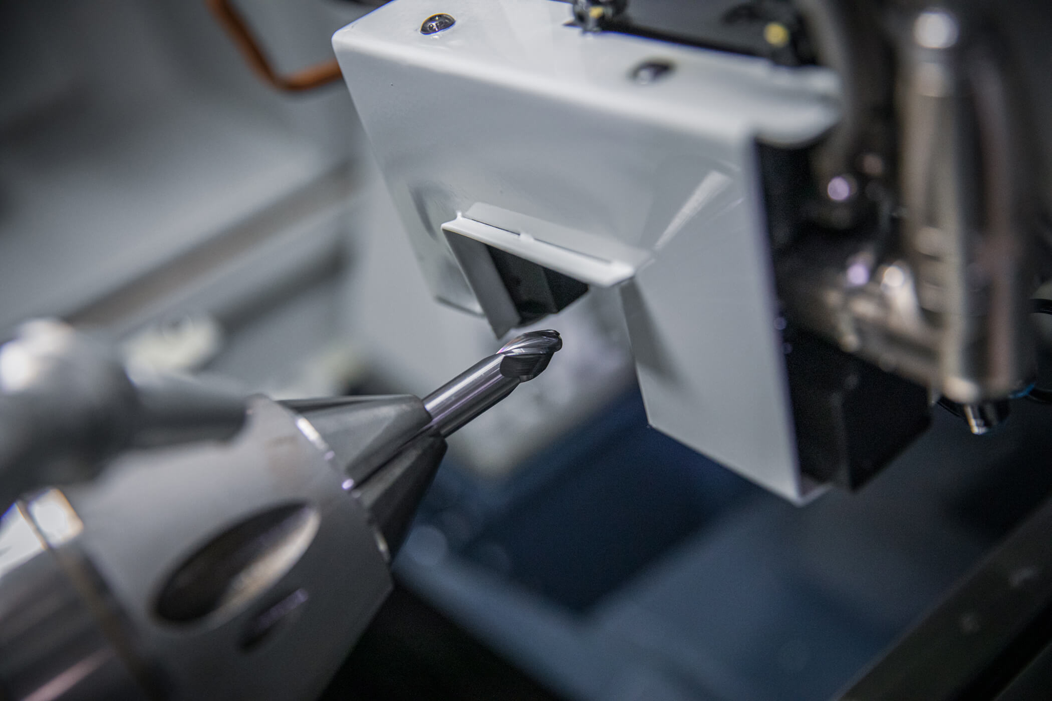

Tool and cutter grinders are very versatile tools that can host a variety of different grinding operations, like surfaces and other complex shapes.
