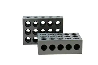

Although not always the case, 1-2-3 blocks typically feature cross-drilled holes. These holes are there for a couple different reasons. For starters, they enable you to connect the blocks to one another and/or to the worktable with bolts, allowing you to create different configurations, making application possibilities endless.
The holes also make the block much lighter, making it easier to handle. These holes can be threaded, though 1-2-3 blocks typically have a combination of threaded holes and non-threaded holes.
Depending on where your 1-2-3 blocks will be used in the shop, it’s important to have an air tool to clean out the holes so that coolant, dust, and chips don’t build up in the hole or interfere with your work.

Calibrate equipment, space workpieces, or collect exact measurements with this set of precision 1-2-3 blocks. Each block measures 3x2x1 inches, perfect for machinists. The WEN blocks feature five threaded M10-1.5 holes and 18 unthreaded holes.

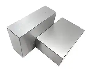

As mentioned earlier in the article, not all 1-2-3 blocks have holes, like this Taytools model. The block was produced from professional quality precision ground steel and case hardened to RC 55-62 on all six sides. The squareness on all sides is within 0.0002″.
