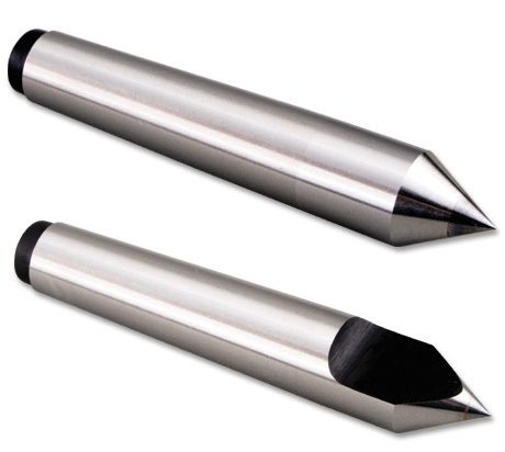

There are two commonly used types of dead centers. The standard dead center and half dead center are similar in function, but differ in that the half dead center has half of the conical shaped point. The image below showcases that anatomical difference.
Credit: www.groz-tools.com
Half dead centers are used for projects where the workpiece is smaller than the dead center itself. The portion that is cut away allows clearance, whereas with the standard dead center clearance wouldn’t be achieved.
