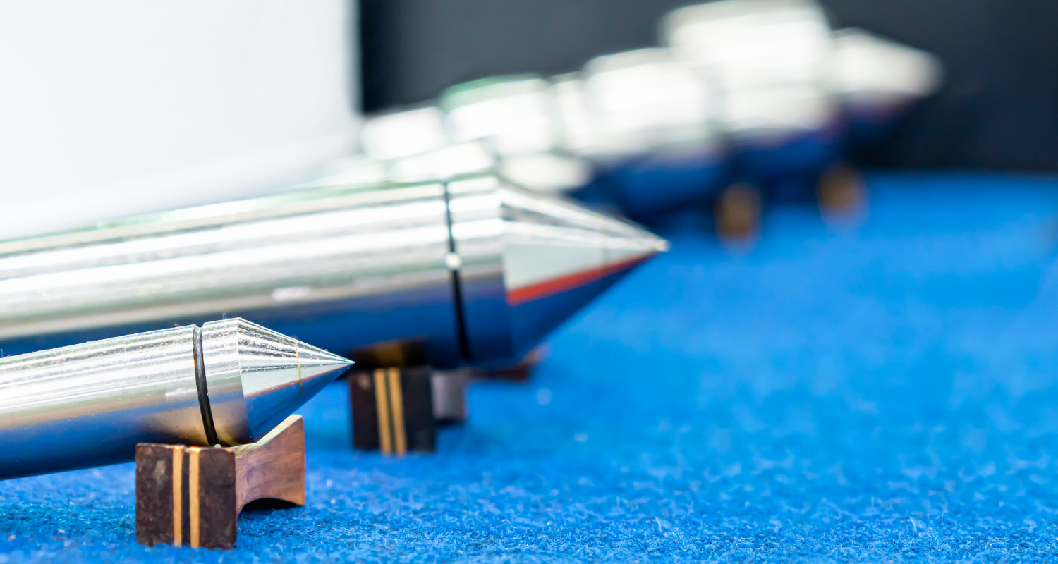

If you need extra support during your lathe application because your workpiece extends a decent distance away from the jaws holding it in place, you’ll want a live center. A live center is a tool bit placed between the headstock and tailstock of a machine tool. It is used to support a long workpiece and reduce “flex”, thus preventing chatter and a compromised surface finish.
Let’s take a look at how live centers work, the different types and how to select the right one for your application.
Why use a live center?
A word you will frequently hear when referencing a live center is concentricity. The core role of the live center, in technical terms, is to produce concentric work. Concentric means having a common axis or being coaxial. This is a fundament of geometric dimensioning and tolerancing. If you’re interested in digging a bit deeper into GD&T and its connection to live centers, check out Understanding Geometric Dimensioning and Tolerancing.

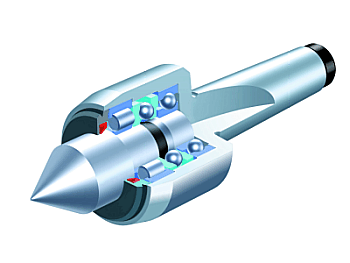

Anatomy of a Live Center
Now that we know what a live center is used for, let’s discuss its components and their functions.
Image Credit: https://www.karlbruckner.de/en/
The tapered end is inserted into the tailstock; the opposite end is a conical shape that connects with the workpiece. The conical head spins on the pre-loaded bearing assembly you see above. Those bearings are what allow the free rotation of the conical head.
A live center typically includes a protective ring between the conical head and the bearing base. That ring acts as a shield to protect the tool from harmful contaminants like dust and coolant, thus increasing the longevity of the bearings.
In order for the live center to be held in place, you’ll have to bore a small hole at the end of your workpiece so the live center can make, and hold contact with the workpiece.

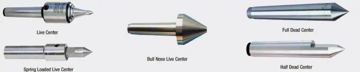

Types of live centers and tips for selecting the right one
Live centers come in a variety of different types and shapes. Some of them are more suitable for high-precision work, such as grinding applications, while others work better with larger parts or parts with larger center holes.
In the image below, you will find examples of the different types of live centers (along with some examples of dead centers), each with specific anatomy to support various application needs. Learn more about the different live center types here.
