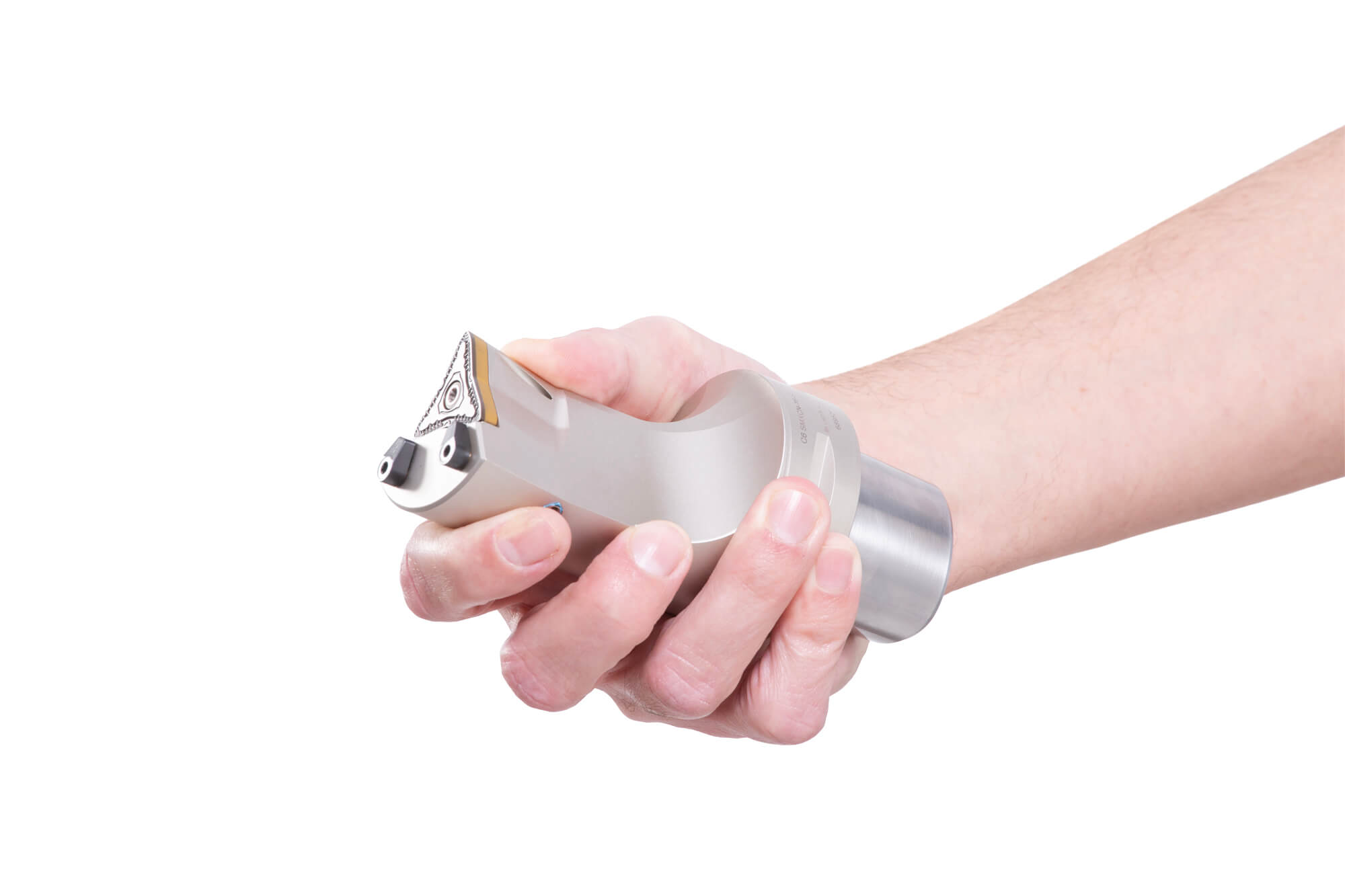

A 3 edge multidirectional turning insert
Iscar QuickTLock is a highly versatile insert to allow turning in multiple directions.  Pocket design employs Iscar’s ‘safe-T-lock’ clamping to prevent any insert movement in the pocket when changing direction of cut.  The new Y-AXIS holders allow for insert stability while under high machining forces without vibration or chatter.
