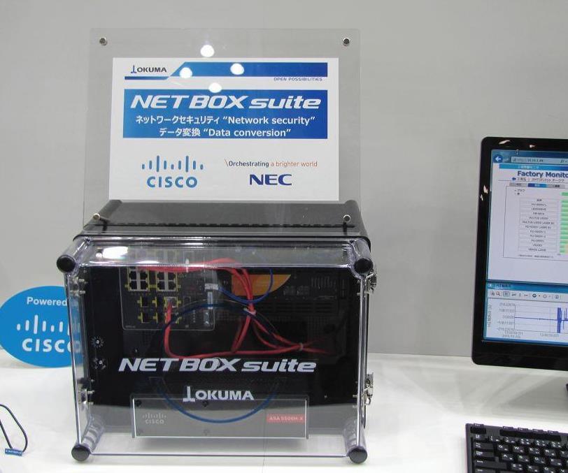

Incorporating a configurable network switch is an effective, manageable approach to keeping connected machine tools safe from security threats on a network. Okuma’s Netbox Suite, which includes a network switch, becomes part of the machine’s electronic control system. One use for it is to give a legacy machine secure connectivity.

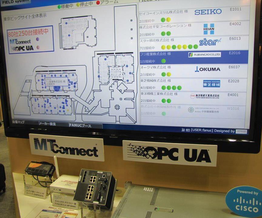

The FANUC booth had this IIoT display showing the status of almost all of the machine tools running at JIMTOF. Network hardware and software for the FANUC Intelligent Edge Link and Drive (FIELD) System were also featured.

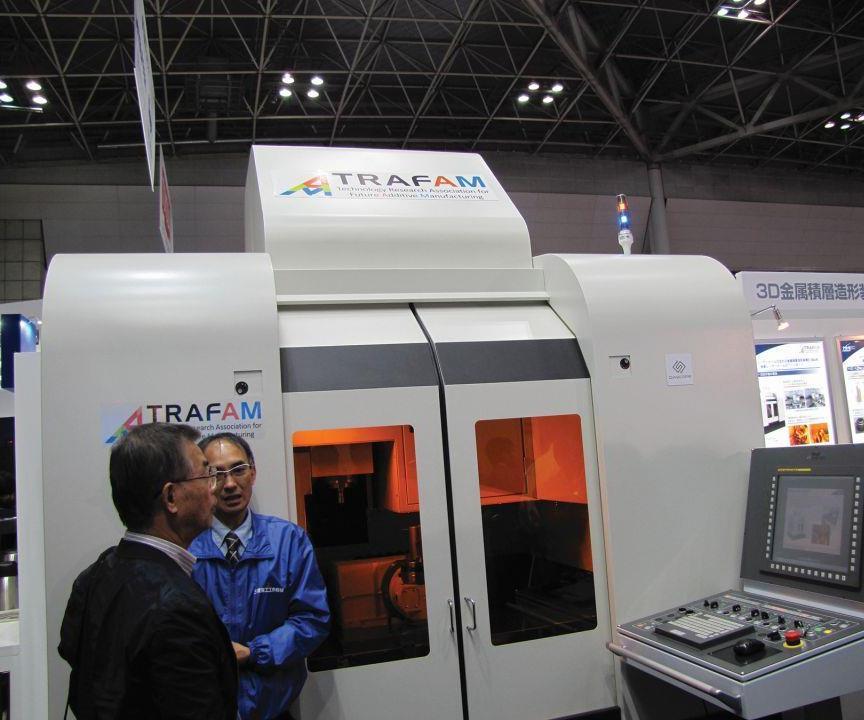

Japan’s focus on hybrid (additive and subtractive) machining platforms is part of its Technology Research Association of Future Additive Manufacturing (TRAFAM) program. This government/industry initiative is intended to put Japan in the forefront of additive manufacturing developments.
