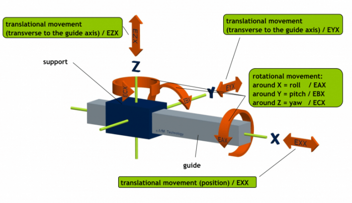

The ball bar also doesn’t identify errors like roll about the axis of travel. And there’s a lot that could be wrong when you consider that every axis has six degrees of freedom (6DOF). As Wolfram Meyer, senior principal for machine tool and CMM calibration at SIOS Messtechnik GmbH, Ilmenau, Germany, explained, the 6DOF for a linear axis are positioning deviation, movement up and down, lateral movement, pitch, yaw, and roll. There are also 6DOF for each rotary axis. The actual deviation at each nominal position is represented as a set of values called a “component deviation.”
On top of that, Meyer explained that you also have to consider the “location deviations” for each axis, three for each linear and five for each rotary axis. A linear axis is almost always designed to be perfectly square with respect to two other linear axes (e.g., a 90° angle between X and Y and X and Z) and the angles describing the difference between the actual axis and ideal axis are summarized as three squareness errors. Rotary axes are more difficult to explain but each has five such deviations. Add it up for a five-axis machine with three linear axes and two rotary axes and you have 43 possible deviations. (3 x 6 + 3 for the linear axes and 2 x 6 + 2 x 5 for the rotary axes.)
Three translational and three rotational movements comprise the six degrees of freedom of a single linear axis (in this case X). A typical five-axis machine has 43 possible deviations, not counting the spindle. (Provided by SIOS Messtechnik)
Meyer also explained that 80 percent of the error in a rotary axis usually comes from location deviations and 20 percent from component deviations, while it’s the opposite for linear axes.

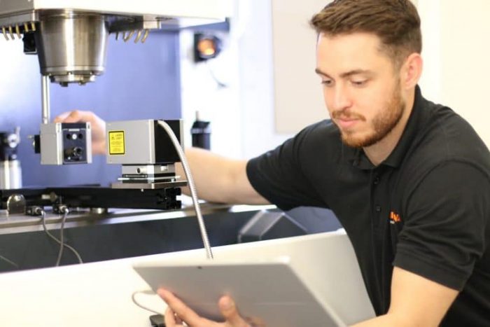

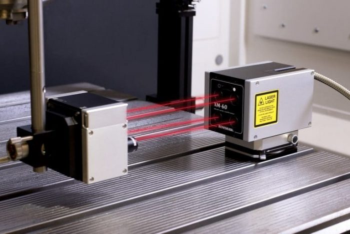

Identifying and measuring some of these deviations is best done with a laser interferometer. Some laser systems, like the SIOS SP15000 C5 and the Renishaw XM-60, even measure all 6DOF simultaneously while moving down the axis. (Strictly speaking, the SIOS C5 measures 5DOF with the laser and simultaneously measures roll with an electronic level.)
The accuracy of these systems is traceable to international standards and as good as you can get because, as Renishaw’s Wilm explained, you’re measuring with the wavelength of light, the unit on which all length measurements are based. These units even account for the effect of air temperature, air pressure, and humidity on the light. For example, Wilm said a change of 1°C could cause a one ppm uncompensated error in a measurement. All environmental factors taken together could add up to a 20-50 ppm error in a measurement if not compensated.
But these are insignificant compared to ignoring or mistaking material temperature. “If I’m using a thermal expansion coefficient of 10 ppm, I’d have a one micron per meter uncertainty and just a 0.1°C uncertainty would cause a one ppm error.”
So if a temperature measurement is off by 1°C when machining aluminum (coefficient of expansion of 24 ppm), the error will be 24 µm/m, which becomes significant in some applications. Meyer said that in addition to providing critical information for compensating the nominal position, constantly measuring the temperature and visualizing the gradients “provides a lot of information about the machine structure, its thermal behavior, and the quality of the calibration process. But to do that easily you need wireless sensors like the LCS System from SIOS.”

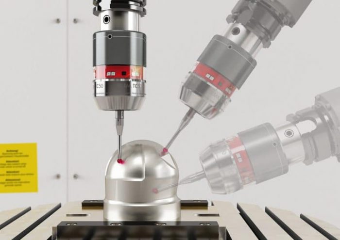

Okuma also offers a Five-Axis Auto Tuning System that uses a touch probe and a datum sphere to measure and auto-compensate for 11 types of geometric errors in about 10 minutes, or a fuller set of adjustments in 30 minutes. For example, Cagle explained, if the X and Y axes are straight but the probe detects a slight error in Z, the control could “interpolate a straight traverse in Z, perhaps by moving X two microns over the course of a meter.”
In another example, multi-sided machining with tools inclined at different angles for each surface, the system automatically improved the maximum machining surface error from 25 to 10 μm. Meyer added that Siemens, Heidenhain, and Fidia also offer software options that use a sphere to compensate for deviations in rotary axes.
The Renishaw XM-60 laser interferometer measures all six degrees of freedom simultaneously while moving down the axis. (Provided by Renishaw)
