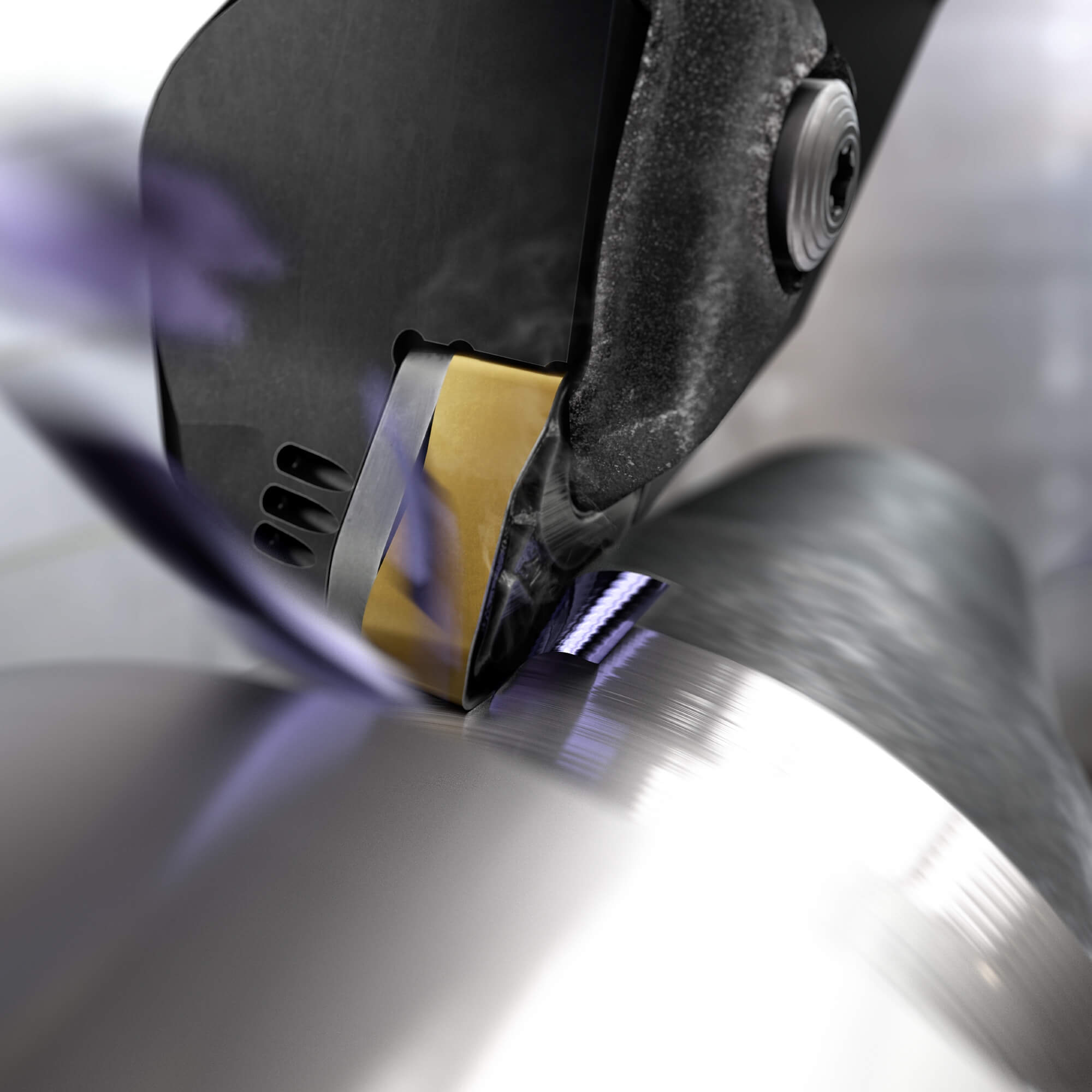

If the insert machines the workpiece at a near-to-90° angle, then the thickness of the chip will be equal to the feed rate (fn) — so, at an fn of 1 millimeter per revolution (mm/rev), the chip will be 1 mm thick. If we reduce the entry angle, the smaller we go and the thinner the chip thickness will be. We can increase the fn accordingly. So, for example, if we decrease the entry angle from 90° to 25° while increasing the fn from 0.25 up to 0.6 mm/rev, the chip thickness will remain the same. The result is more productive machining with the same levels of chip control.
To support this, Sandvik Coromant has created its PrimeTurning™ methodology, which includes machining with a small entry angle to give very high productivity and long tool life. The method allows customers to do turning in all directions, and, in doing so, they can achieve greater efficiency and productivity than is possible with conventional turning. PrimeTurning has resulted in increased productivity and longer-lasting tool life for customers.
However, the process needs specific tooling to unlock these advantages. A conventional tool won’t allow the same levels of chip control or the right clearance angles and so will not work in practice. That is why Sandvik Coromant has developed CoroTurn PrimeTurning tools, of which the latest development is the second-generation CoroTurn Prime B-type inserts. The next-generation tool features double-sided negative inserts with four cutting edges designed for more cost-efficient machining, along with a new robust tip seat design and updated geometries. With these features, the tool can perform deeper cuts (mm), with higher machining (mm/rev) and fn speeds, plus improved chip control while machining high-strength steels and other tough steels.
This benefits productivity, but what about tool wear? This brings us to the design of the insert itself. With a conventional insert, machining at a smaller entry angle puts the majority of the heat and load into the corner of the insert, which also happens to be the insert’s weakest part with the least amount of carbide to absorb it. Instead, each next-generation CoroTurn Prime B-type insert has four cutting edges rather than two, with stronger corners. With more edges, more machining can be achieved with each insert, while heat and load is spread over a much bigger portion of the cutting edge.
The second-generation CoroTurn Prime B-type insert is also designed to overcome issues normally experienced when using inserts at a higher axial depth of cut (ap) and fn. That includes risks of overload and, at lower ap and fn, the risk of long chips. Machining operations can therefore be run at a much higher fn for improved chip control, stability, improved process security and better tool life. For manufacturers, meeting these higher standards of quality and efficiency can be met by implementing improvements at the machining stage.
