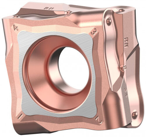

FIX8 has eight cutting edges per insert, providing the lowest cost per edge. The tangential design allows it to sustain far higher loads than traditional designs.
The tangential design of the FIX8 insert features a rigid clamping system that pulls the insert securely into the pocket seat, offering superior stability that enables the insert to withstand large cutting forces and vibrations for optimal performance. The insert is also supported by a replaceable carbide shim, protecting the pocket against deformation and damage.

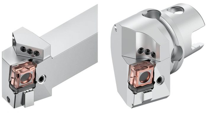

The FIX8 tool holder features precision 3D coolant technology, supplying sufficient coolant precisely where needed. Three coolant nozzles are directed to the rake face, controlling temperature, chip evacuation, and supporting chip formation. Coolant exit holes in two different locations are directed toward the flank of the insert, controlling the heat in the cutting zone and prolonging tool life.
FIX8 tool holder styles featuring precision 3D coolant technology. Delivers coolant sufficiently and precisely to where it is needed.
