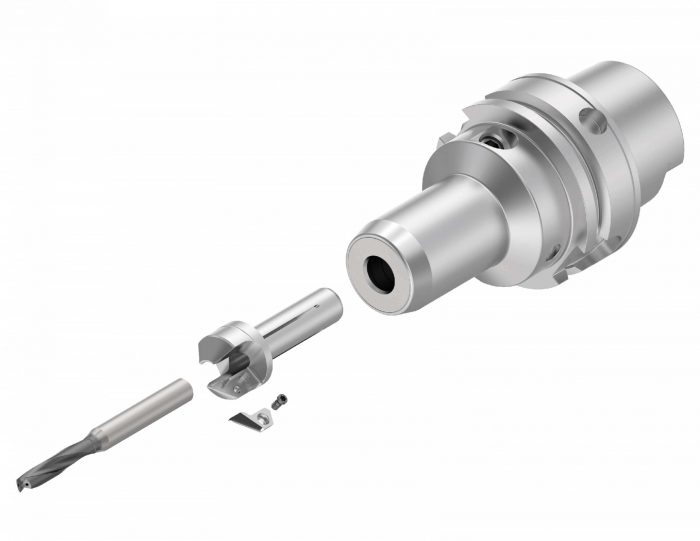

Kennametal’s HiPACS is a cost effective and easy to assemble system comprised of three components: a reducer sleeve, countersinking insert and solid caribe drill. The system works with any standard hydraulic chuck.
Three simple components eliminate the need for custom tooling
Designed to be clamped in a standard hydraulic chuck, the HiPACS modular system consists of three components that are fast and easy to assemble:
-A reducer sleeve with a built-in high-precision pocket seat. In conjunction with a standard hydraulic chuck, this component provides ultra-secure clamping and a runout of no more than 3µm, significantly increasing tool life and hole quality.
-A PCD countersinking insert. This eliminates the need for expensive custom solution step drills, reducing manufacturing costs while meeting the industry’s accuracy requirements.

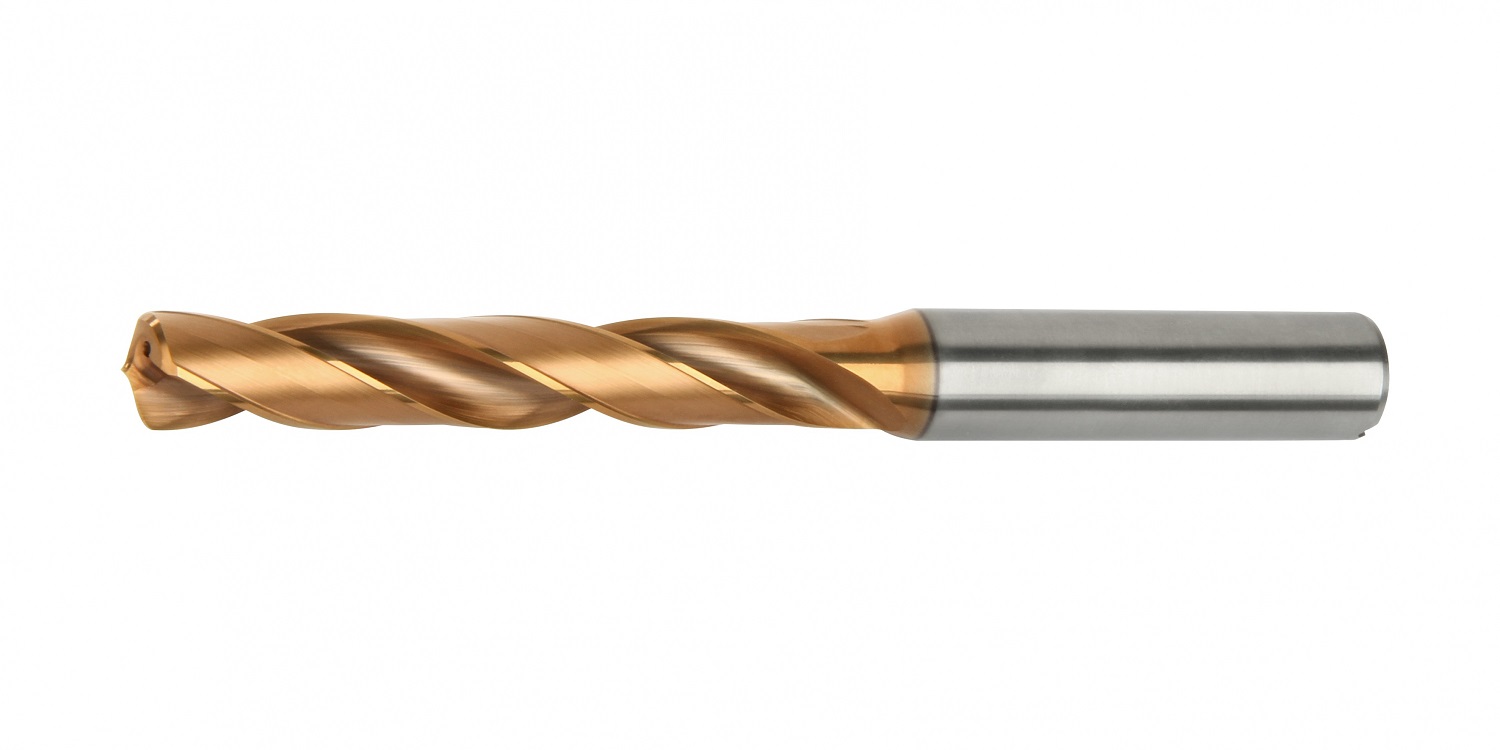

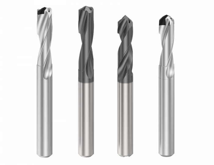

-The two series of solid carbide drills —both diamond-coated and PCD-tipped—covering all material combinations found in a typical aerospace assembly. In addition, the straight shanked tools allow for length adjustments in increments of 10mm.
HiPACS system utilizes standard PCD-tipped or diamond coated solid carbide drills
The new HiPACS drilling and countersinking system can be utilized on all machines typically used for aerospace applications. In less stable conditions such as robot end effectors, the diamond coated carbide drills offer excellent tool life and hole quality. PCD-tipped drills, on the other hand, excel in stable conditions such as gantry machines.
