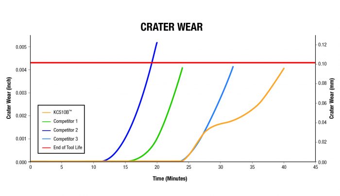

KCS10B, which features a revolutionary coating applied to an ultra-fine grain carbide substrate for superior layer adhesion, delivers up to 50% greater tool life, more predictable processes, and improved productivity when working with difficult to machine superalloys. KCS10B overcomes the most common challenges encountered in turning superalloys—cratering and depth-of-cut notching—two wear modes that often lead to unexpected and even catastrophic tool failure.

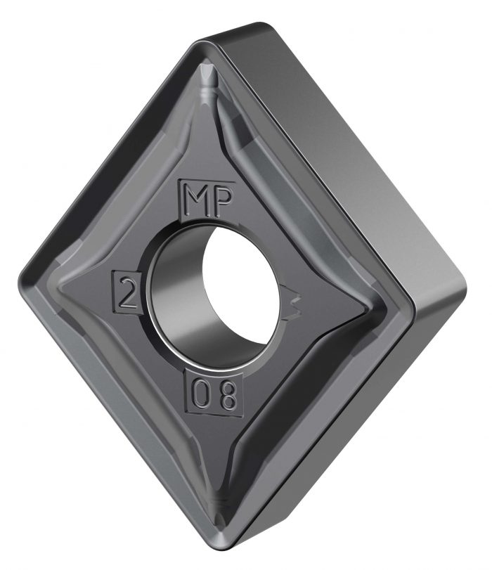

KCS10B is available in the most popular turning insert shapes, sizes, and geometries

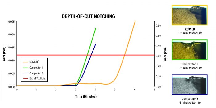

Metals such as Inconel 718 and Stellite 31 are notorious for causing rapid wear and unpredictable tool life, KCS10B is proven to reduce DOC notching and extend tool life from 3 minutes to upwards of 5 minutes in roughing operations. Tool life in finishing operations fares even better, with visible cratering and subsequent tool failure often delayed by a factor of two or three compared to competitive brands.Positive and negative rake inserts are available, as well as various chip formers, edge preparations, and geometries, making KCS10B the ideal solution when turning iron-based (S1), cobalt-based (S2), or nickel-based (S3) alloys.
Inconel 718 (NiCr19FeNbMo DIN), 36-39 HRC, Continuous Cut, Flood Coolant. Cutting Conditions: 61m/min (200 sfm) , 0,25mm/rpm (0.0096 ipr), 1,5mm doc (0.06” doc)
Depth-of-cut notching and crater wear are far more manageable thanks to the super smooth coating and special edge-prep of inserts coated with KCS10B.

Inconel 718 (NiCr 19 FeNbMo DIN), 36-39 HRC, Continuous cut, Flood Coolant. Cutting Conditions: 91 m/Min (300 sfm), 0,15 mm/rpm (0.006 ipr), 0,25 mm doc (0.01” doc)
