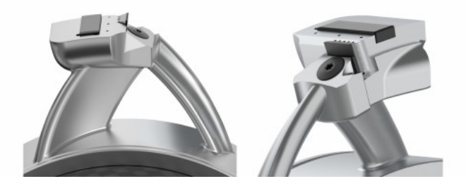

The airfoil shaped arms with through coolant and RIQ reaming technology. Complex internal and external features enabled by additive manufacturing.
Hassle-free chip removal is ensured by means of airfoil shaped arms that are through coolant featured to ensure precise and powerful coolant supply to the cutting edges and guide pads. This would be difficult or impossible to economically produce with traditional manufacturing, but 3D printing enables us to realize even such complex internal features. Additionally, the Kennametal RIQ reaming system features easy diameter adjustment and a trouble-free setup of new inserts.
