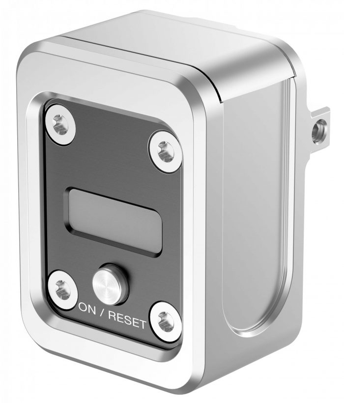

Offering no-mistake adjustments and accuracy to within 2 microns, Kennametal’s eBore digital device is an optional—though extremely useful—part of the Kennametal Digital Boring System
Ease-of-use

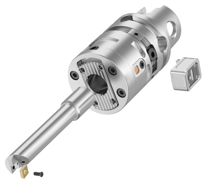

With Kennametal’s digital eBore digital device, dialing in a tight bore and losing count of how far the adjustment screw was turned is a thing of the past. With an adjustment accuracy of 0.002 mm (0.00008”), the chip and coolant-resistant device contains a glass-scale that keeps track of boring bar movement. Simply snap it in place, turn the boring head’s adjustment screw by the desired amount, and the tool is ready for the next boring operation.
With eBore, there is no need to remove the boring head from the spindle for adjustment nor to count graduations or take notes. Concerns over backlash and movement due to overtightening of the boring head’s locking screw are a thing of the past, as are endless test cuts and “sneaking up on the bore”. The result is less scrap, less downtime, and faster setups. The device shuts off automatically after 30 seconds and provides more than 5,000 adjustments between battery changes. And if you forget to remove the boring head before turning on the spindle, a ball and spring clamping mechanism releases the display automatically at 500 RPM, preventing potential injuries.

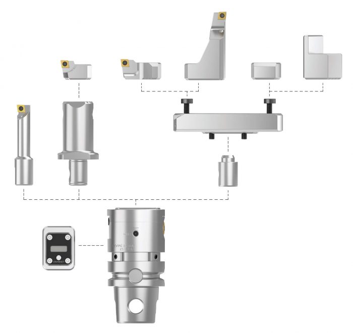

eBore Universal: one head, multiple configurations, large diameter and boring depth range. The eBore digital display allows precision adjustment on the spindle, reducing setup time and idle time.
Boring small and very large diameters
The eBore product line consists of 4 types of tools, all of them feature through the tool coolant, covering the following diameter range:
-eBore Universal Tool – 6-152mm (0.236”-5.984”)
-eBore Fine Boring Tool – 20-205mm (0.787”-8.071”)
-eBore Bridge Finishing Tool – 200-1020mm (7.874”-40.157”)
-eBore Twin Cutter Roughing Tool – 19.5-1020mm (7.677”-40.157”)

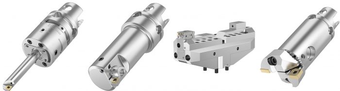

eBore Tool types from left to right: eBore Universal, eBore Fine Boring, eBore Bridge Tool. eBore Twin Cutter.
