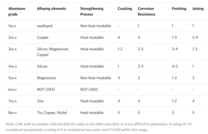

Cast aluminum is melted and then poured into a mold. It has larger percentages of alloying elements than wrought aluminum. Due to its low tensile strength and flexibility, cast aluminum is most often used for making machine tools, engine cylinder heads, gearbox housing, cast wheels and more. It is also the cheaper option when compared to wrought aluminum.
See the image below for a breakdown of the different cast aluminum grades and Information about their properties.

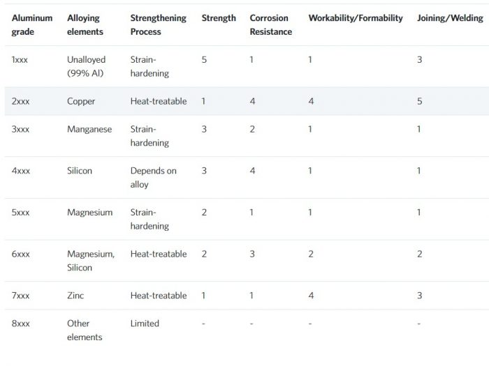

After the smelting process, the alloy is manipulated either by being rolled, forged, or extruded into a final shape. Due to its higher tensile strength, wrought aluminum is most frequently used in extrusions, aircraft frames, pressure vessels and more. With wrought aluminum, you can expect better surface finishes and structural integrity as opposed to cast aluminum.
See the image below to for breakdown of the different wrought aluminum grades and information about their properties.
