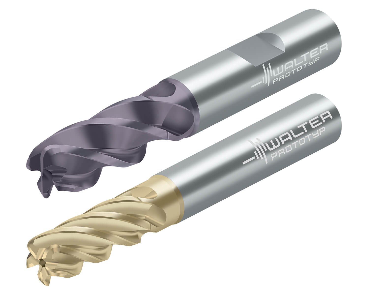

5 tips to increase your productivity when machining titanium
1. Enter titanium with an “arc in”: With other materials, it’s OK to directly feed into the stock. Not with titanium. You have to glide in softly and in order to do this, you will need to create a tool path that arcs the tool into the material as opposed to entering via a straight line. This arc allows for a gradual increase in cutting force.
2. End on a chamfer edge: Avoiding abrupt stops are key. Creating a chamfer edge before running the application is a preventative measure you can take that will allow the transition to stop to be less sudden. This will allow the tool to gradually decline in its radial depth of cut.
3. Optimize axial cuts: There are a couple things you can do to improve your axial cuts.
    • Oxidation and chemical reaction can occur at the depth of cut. This is dangerous because this damaged area can result in work hardening and damage the part. This can be prevented by safeguarding the tool which can be done by changing the axial depth of cut for each pass. By doing this, the problem area is distributed to different points along the flute.
    • It is common for deflection of pocket walls to occur. Instead of milling these walls to the entire wall depth with just one pass of an end mill, mill these walls in axial stages. Each step of the axial cut should not be greater than eight times the thickness of the wall that was just milled. Keep these increments at an 8:1 ratio. If the wall is 0.1-inches-thick, the axial depth of cut should be no more than 0.8 inches. Simply take lighter passes until the walls are machined down to their final dimension.
4. Use generous amounts of coolant: This will help carry the heat away from the cutting tool and wash away chips to help reduce cutting forces.
5. Low cutting speed and high feed rate: Since temperature is not affected by feed rate nearly as much as it is by speed, you should maintain the highest feed rates consistent with your machining best practices. The tool tip is more affected by cutting than any other variable. For example, increasing the SFPM with carbide tools from 20 to 150 will change the temperature from 800 to 1700 degrees Fahrenheit.
