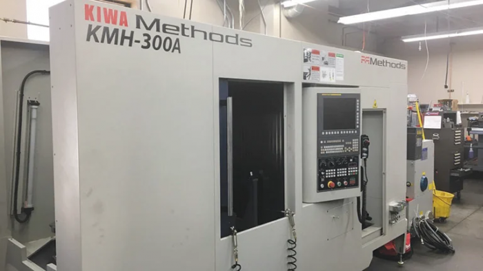

One of the Kiwa KHM-300A machines installed at Alicat Scientific’s Tuscon manufacturing operation.

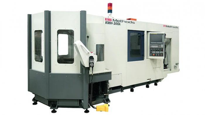

Harrod knew that floor space in Alicat’s shop was limited, which is one of the reasons it hadn’t explored an HMC before. He brought up the Kiwa KMH-300A from Methods, as it was a 300-mm machine that fit the shop’s spacing needs and was perfect for the part it was cutting.
“I was skeptical about the capability of the KMH-300A because I was told by other salesmen I was talking to that a 300-mm machine doesn’t have the capability to cut stainless, but the small footprint while being able to handle our part was a huge game changer for us,” said Camron. “We decided to take a shot with the KMH-300A and trusted Tony when he said it would be able to handle the job. The results blew us away.” Kiwa KMH-300 PC2 machines (with standard two-pallet changer) have a footprint of 140 x 107″ (3,556 x 2,718 mm) and the KMH-300 PC6 (with optional six-pallet changer) has a footprint of 196 x 165″ (4,978 x 4,191 mm).
The Kiwa KHM-300A PC6 from Methods, which includes a horizontal machining center and a six-pallet pool and changer.
The first KMH-300A was delivered to Alicat’s facility within one week of the order being placed and was cutting just one week after install. Six weeks after install the KMH-300A was performing well beyond expectations, and the immediate production prompted Alicat to purchase another KMH-300A right away. The two machines were able to pull the shop out of its production hole and get production lead times back down to a maximum of five days. “We are cutting 316 stainless at 140 ipm (356 cm/min) and 303 stainless at 200 ipm (508 cm/min),” said Camron. “The machines are cutting so well that it sounds like I am cutting aluminum instead of stainless steel.”
The two KMH-300A HMCs sustained the shop’s production until 2017, when Alicat underwent another period of massive growth. The manufacturer immediately added another KMH-300A, but this time with a PC6 pallet pool. The added pallets allowed Camron to run the machines unattended overnight, trusting the reliability of the machines. Alicat can run the PC2 for five hours unattended, and its new PC6 can run overnight. An additional KMH-300A PC6 was purchased a year later, which has kept up with Alicat’s continued rapid growth by allowing for more unattended operation.
