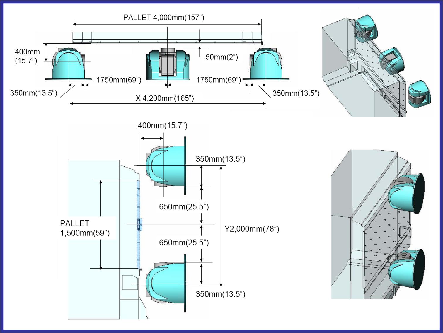

The first machines of Makino’s T-series include the T4 and T2 five-axis horizontal machining centers. The T4 provides X, Y and Z axis travels of 4,200mm, 2,000mm and 1,000mm respectively, and can hold workpieces up to 5,000kg. For smaller titanium parts, the T2 provides X, Y and Z axis travels of 2,000mm, 2,000mm and 1,800mm respectively, and can hold workpieces up to 5,000kg.

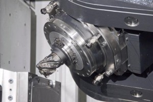

The T-series’ HSK-A125 spindle is Makino’s most powerful spindle to date, providing higher torque, horse power, and clamping force than all predecessors. Its compact design combines the latest induction motor with twin inverter drive technology for higher torque (740ft-lbs, 133HP continuous; 1,100ft-lbs, 200HP peak). The spindle is supported by roller bearings to ensure high rigidity, which keeps the energy loss to one-half that of conventional gear-driven spindles. The spindle delivers a maximum speed of 4,000RPM. The A and C-axes increase part accessibilitywith a ±110 degree A-axis rotation and a 360 degree continuous C-axis rotation.
