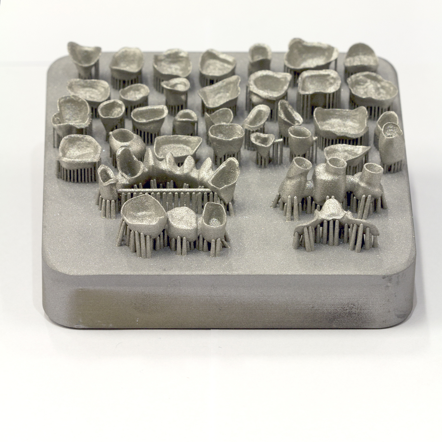

Argen prints several crowns and bridges, shown here on a 90 by 90-mm build plate, per production cycle on its Concept Laser Mlab 3D metal-printing machines.

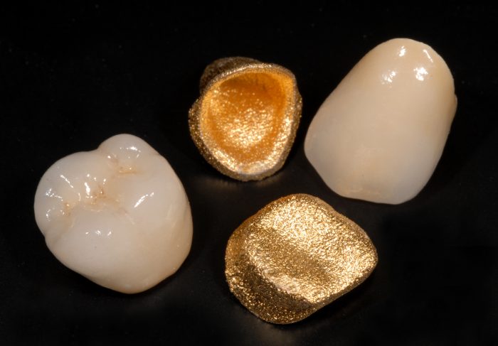

Argen also worked with Concept Laser to develop a unique sintering process to manufacture its proprietary Captek crowns. Printed on the Mlab machines, these unique crowns combine a 3D-printed layer of a platinum-palladium-gold alloy that’s sintered to 50-percent dense, which then is infiltrated with gold and veneered with porcelain.
“The process creates a strong core with an attractive outer surface,” Cascone says. “The traditional manual fabrication of these crowns was very labor intensive and reliant on the skills of our technicians. Now we build the initial layers on the Mlab with a significant increase in productivity and throughput.”

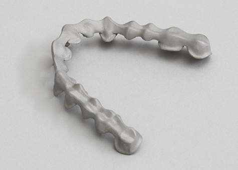

An example of the type of work Argen can produce on its 3D metal printers—a 14-unit bridge.

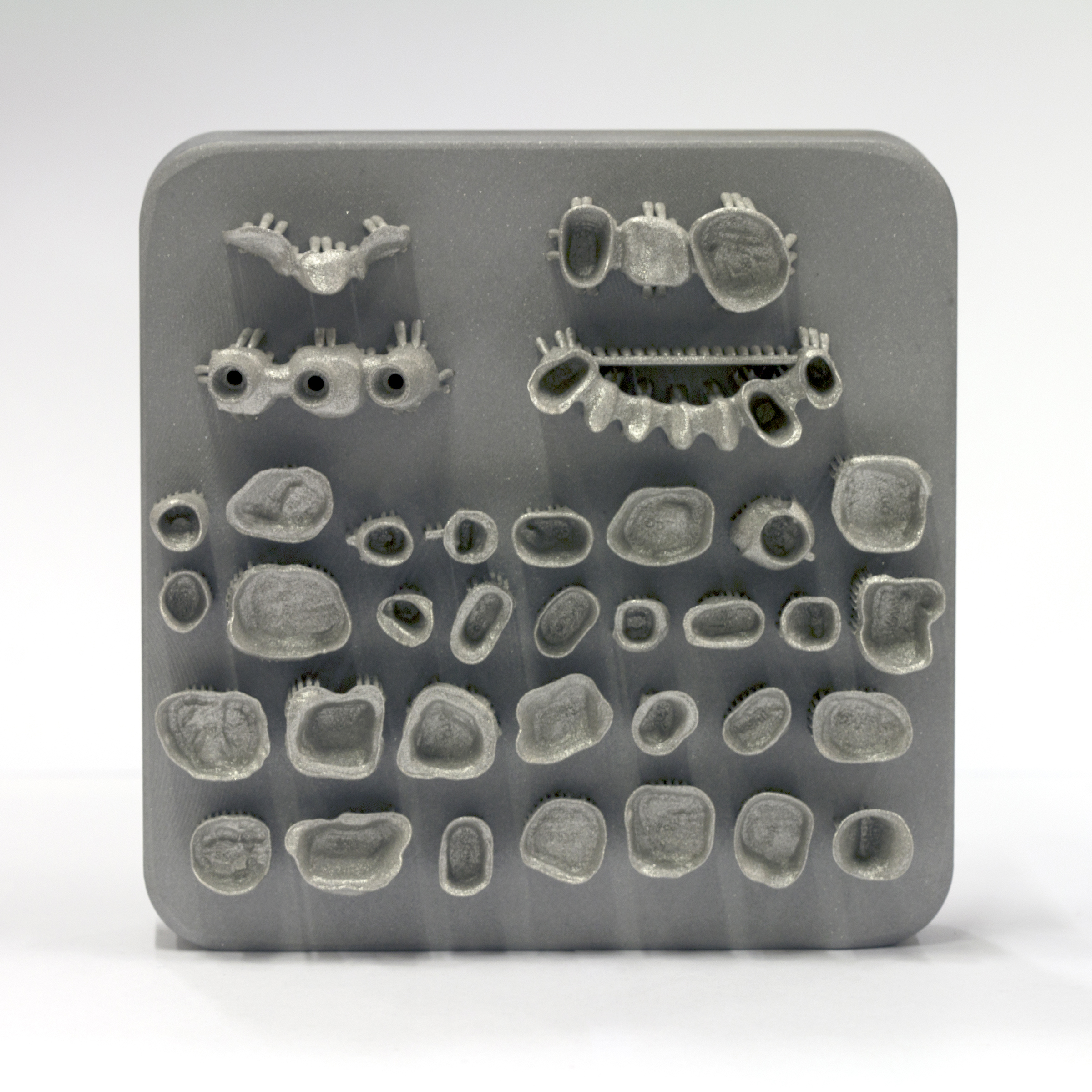

Most of the dental parts printed at Argen Digital are of cobalt-chromium or of precious-metal alloys of gold or palladium. It employs two Mlab modules with a build area of 50 by 50 mm for research and development, and nine 90 by 90-mm modules for production; all of the models have an 80-mm build height. Each build plate in production at Argen typically contains 40 to 60 dental parts, representing “true mass customization,” Cascone says. “We turn the builds around in 24 hours.
“We’ve been working closely with Concept Laser to fine-tune the annealing cycle,” he continues, “particularly in regards to fabricating bridge work. We’ve also been working to establish the proper number of supports needed for a given job, and the proper geometry of the supports. The key to ensuring repeatability and accuracy is managing residual-stress buildup during the build, via the supports, and then fine-tuning the annealing process to relive built-up stresses after the build.”
The Argen SLMCaptek crown is printed on a Concept Laser Mlab machine, and then infiltrated with gold and veneered with porcelain.
