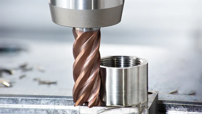

Advanced cutting tools can maximize metal removal rates (MRR)when machining even the most difficult-to-machine materials. Powered by the latest CAM programs, these machining strategies are known variously as high-speed, high-efficiency, optimized roughing and also by proprietary brand names like Mastercam’s Dynamic Milling. Tools such as multi-flute, solid-carbide tools benefit from the latest advanced technologies in machine look-ahead, high-speed spindles, coatings and geometries.
Seco Tools has developed specific geometries, coatings, carbide substrates and edge preps for machining difficult-to-machine material applications.
Here’s how leading tooling manufacturers are helping customers put these tools to work in machining titanium, nickel-based alloys, superalloys, Inconel and stainless steel.

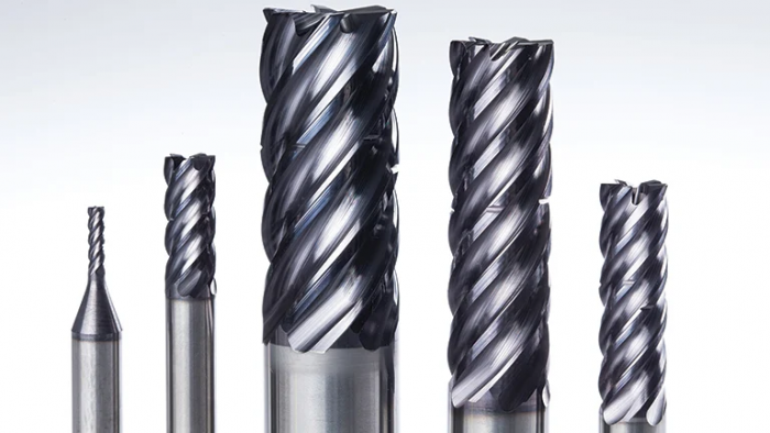

The ECP-H7-CF multi-flute (seven flutes) end mill has a hard substrate, IC902 ultra-fine carbide grade with 9 percent cobalt, and is TiAlN PVD coated. It is suitable for machining various materials, including hard steel and cast iron, at high cutting speeds, according to Iscar.
The ECY-S5 end mill with five flutes features a general-purpose substrate and AlTiCrSiN coating (IC608) for shoulder or full slot high-speed milling or trochoidal or peel milling. Its primary application is stainless but it can also be used to machine nickel-based, high-temperature alloys.
The ECI-H4S-CFE end mill is a short, four-flute design with different helixes (35o and 37o) and variable pitch for chatter dampening. It can be used for high MRR roughing and finishing, with full slot milling up to 1×D. It is also available with the new AlTiCrSiN IC608 coating for machining at elevated temperatures.
The ECKI-H4R-CF four-flute end mill features corner radii for aerospace applications and either of two coatings, IC300 TiCN or IC900 AlTiN. It offers variable pitch and variable helix and a special edge prep for machining titanium.

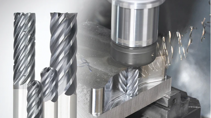

Horn’s DS line of end mills, including DSFT trochoidal end mills, are well suited for increased machining speed demands and challenging materials, according to the manufacturer.
It’s important to have the right CAM software to avoid wasted rapid travel movement, which increases cycle time. There are times when it is better to take a more conventional cutting pass. One example is when the width of cut is short with, say, a 0.5″ (12.7-mm) end mill with the intention of cutting a length of the part that’s 0.5″ long and the process needs to remove 0.3″ (7.62 mm) of material. In this example, Horn recommends taking all the material off in one or two passes instead of 30 passes. To be efficient, the tool must stay on the part and limit time-wasting retraction.
Besides the component, programming strategy and software play into this as well. If a shop is performing high-efficiency or high-speed milling, it must have the horsepower and torque required to drive the tool. If it runs the wrong software, there will be a lot of costly, wasted moves.
Horn’s solid-carbide tools with seven or nine flutes with large DOCs and 10-15 percent stepover—as a rule of thumb to start with—help with these strategies, but the machine tool must have the required acceleration and deceleration. An older machine with rapids of 600 ipm will not be sufficient. Similarly, the look-ahead that newer machines have is also required.
Horn’s DSFT end mills—part of the DS line of high-DOC, low-radial-engagement tools—are designed for trochoidal machining. To be effective, DS tools require a solid machine spindle with close runout and a capable controller for programming. CAD programs are available to create simulation of machining time estimates to decide whether traditional end milling or high-speed machining is best. In addition, there are a number of software tools available to evaluate the economics of these tooling decisions.
The highest MRR possible in high-speed machining with multi-flute tools occurs when the process engages the full flute length of the tool. The more flutes, the larger the core diameter for rigidity. Typically, the first thing to look at when considering high-speed machining is the size of the part and flute length to decide the diameter of the tool, according to Horn. An inch of actual flute length might be handled by a 3/8″ (9.5-mm) diameter tool, and two inches of actual flute length by a 5/8″ (15.8-mm) diameter tool.
The goal is to maximize flute length because that’s what will provide the best MRR in combination with 5 and 10 percent stepovers. Another way to determine tool selection is to decide whether to simply switch to high-feed milling and ramp in with a conventional end mill and rip the stock out.

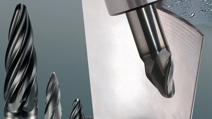

Cycle times for five-axis machining of molds, blades and other complex aerospace and medical parts can be reduced up to 90 percent with Circle Segment solid-carbide end mills, according to Emuge Corp, West Boylston, Mass. While manufacturers performing high-speed machining may be familiar with using traditional ball nose end mills to make small stepover passes, Circle Segment end mills use high stepover passes up to 10 times greater than ball nose end mills to cut out large areas of material, maximizing efficiency and minimizing cusp height.
Circle Segment end mills can reduce cycle times up to 90 percent in five-axis machining of molds, blades and other complex medical and aerospace applications, according to the manufacturer.
According to the company, time and cost savings and increased part quality result. Tool life is increased due to shorter toolpaths. Tolerance deviations due to heat warping at the tool are minimized, and axial deviations of the machine are smoothed, offering a higher quality surface finish in a shorter time frame. Circle Segment end mills feature unique forms with large radii in cutting areas of the mills, allowing a larger axial DOC during prefinishing and finishing operations.
The end mills are available in four geometries: barrel-shaped, oval form, taper form and lens shape. Oval and taper form mills are suited for curved shapes such as blades or straight-walled pockets, freely engaging more of the cutting edge. Barrel design mills provide effective flank milling to the sides of spiral grooves and similar applications, according to Emuge. Lens-shaped mills excel in narrow channels or in lands on molds. Specific CAM systems software, such as Mastercam and hyperMILL, are required to support and compute the geometries.
