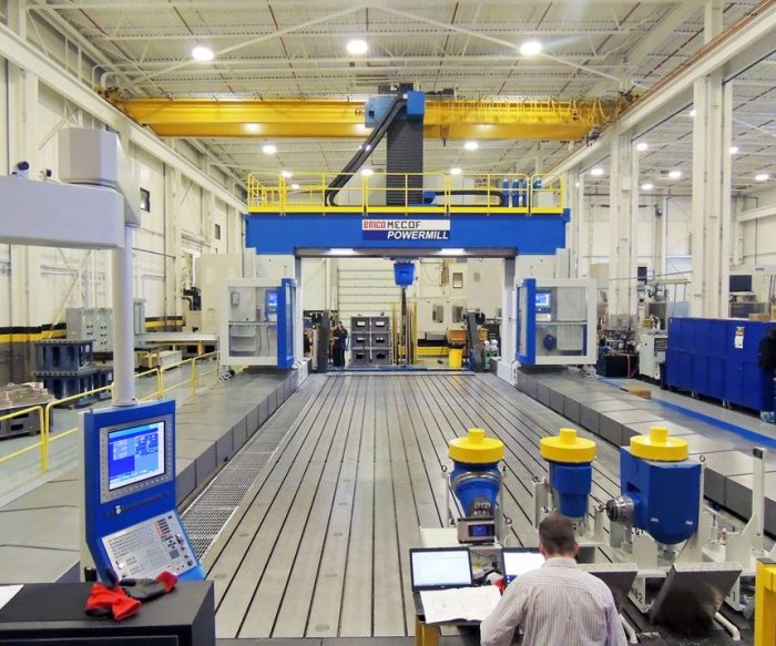

My behind-the-scenes tour on the shop floor of Baker Industries began and ended with its Emco Mecof PowerMill, one of the biggest five-axis machining centers in the United States. The tour also shed light on the company’s highly aggressive approach to new equipment purchases.

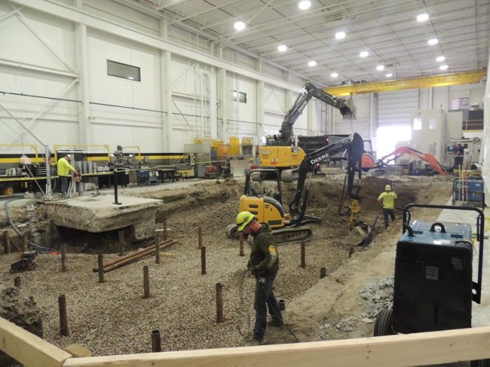

By the time your company invests $3.4 million and 11 months to dig a 45-by-75-by-7-foot pit, fills it with crushed stone and concrete, and tops that with a massive five-axis machine, it is more than likely your operation has experience machining extremely large parts.
That is certainly the case for Baker Industries, a subcontract manufacturer that primarily serves the OEM and Tier-One aerospace and automotive sectors. Baker Industries is located on a vast industrial campus housing several complexes in the Detroit suburb of Macomb, Michigan. And inside one nondescript building on the corner of campus you’ll find a true metal giant — a five-axis vertical machining center with a work table large enough to double as a car pad for a fleet of full-size SUVs.
The Emco Mecof PowerMill represents a $3.4 million investment by Baker Industries to expand its capacity to serve OEM and Tier-One customers’ largest machining projects, typically for the aerospace and automotive sectors. The entire installation took more than two years.

When walking through this building, you can almost see an evolution in size and scope taking place among company’s 35 CNC machines, from smaller vertical three-axis mills, to the (much) larger Breton five-axis machines, to the massive Emco EcoMill. But, situated between a massive American flag and a giant Modern Machine Shop “Top Shops” banner (the company won the award in 2018), the PowerMill looms above them all; its massive work envelope taking up nearly half of the building that houses it.
Installation of the PowerMill began with the removal of 1.2 million pounds of concrete and earth to excavate this 45-by-75-by-7-foot pit. Each truckload of the nearly 2 million pounds of crushed stone and concrete had to be individually sampled by inspectors to ensure it was the right consistency — an extra precaution for a reinforced foundation that has to remain stable beneath an overhead gantry that alone weighs more than 100,000 pounds. The PowerMill’s table has a load capacity of 2.6 million pounds.

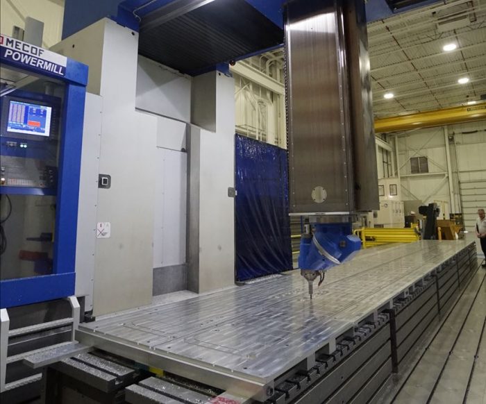

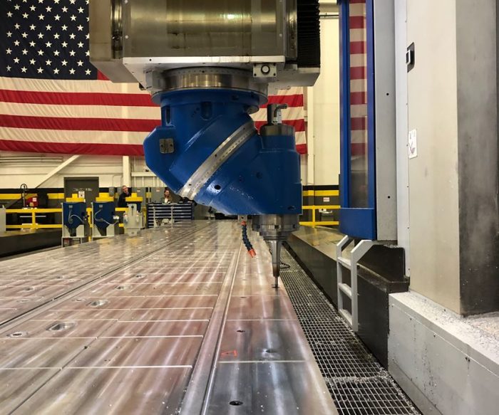

The PowerMill’s table has a load capacity of 2.6 million pounds, much greater than the weight of the eight aluminum workpiece plates that stretched across it 40 feet from end-to-end during my visit. When finished, these plates will be assembled together to form a layup mold for an aerostructure component, although no one at Baker Industries was willing to say exactly what the final component was destined to become.
For all of the mass that the PowerMill represents, the machining center giant can achieve almost shocking precision, able to maintain total error of less than 42 microns along its entire 46-foot-long X axis. This is largely due to the laser trackers that are positioned on the gantry’s two columns. These trackers can be used to help fine-tune the setup process, then continuously scan the workpiece during machining to ensure accuracy is maintained from beginning to end.
Programming the PowerMill is all the more complex when you consider not only the automated tool changing that the machine is capable of, but also the four separate, interchangeable cutting heads that can be utilized for different operations. These heads are powered by spindle motors that reach up to 18,000 rpm, which enable the machine to handle roughing to semi-finishing to finishing all in one setup. Of course, these capabilities make proper setup all the more vital. As Mr. Kablak told me, locking down the proper setup procedure was one of the biggest learning curves for Baker Industries’ larger machining centers. “Even at a smaller scale when you have smaller machines, the same issues are there,” he said. “So on a machine like the PowerMill, you can imagine how all of those issues are amplified.”
Four different interchangeable cutting heads powered by spindle motors that reach up to 18,000 rpm enable the machine to handle operations from roughing to finishing all in one setup. The open structure of the overhead gantry enables the spindle to travel 46 feet in the X axis, 20 feet in the Y axis and nearly 10 feet in the Z axis.
Of course, the nature of the work that requires a machine like the PowerMill is much more likely to be for one-off or low-volume parts, which means that there is no cookie-cutter setup procedure that Baker’s machine operators can rely on. Before the company had the PowerMill and EcoMill in place, Mr. Kablak says that he and his colleagues had gained years of experience machining large parts by creating multiple setups for the workpieces, flipping them over and ultimately passing them through the open doors of smaller machining centers.
Baker Industries’ general manager Bill Ednie told me that the workpieces being machined on the PowerMill during my visit required more than a week to set up, as well all a lot of forethought into how to ensure that each plate was properly stress relieved to reduce the risk of warpage before machining operations began. The vacuum grooves on each of the eight plates had already been machined, and the final step before inspection began was to drill the holes that the customer would use to lock the pieces into place for molding operations.

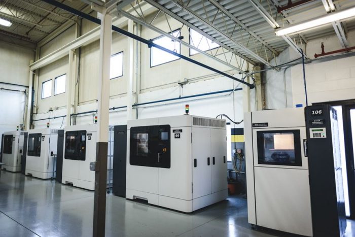

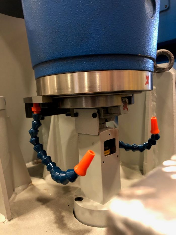

Here is one example of creative thinking that helps keep the PowerMill fed and its spindles turning. Before the end of my visit, Mr. Ednie pointed out an attachment for the PowerMill that took advantage of Baker Industries’ in-house 3D printing capabilities. The company began investing in additive manufacturing (AM) technologies in 2014, and today has seven 3D printers, most of which are Stratasys fused deposition modeling (FDM) machines for plastics, in addition to two EOS direct metal laser sintering (DMLS) machines.
The attachment is a right-angle bracket for a cutting head that contains internal channels for air-cooling passages. By shooting air directly onto the attachment and the workpiece, Mr. Ednie says the cutting head can operate for hundreds of hours on end.
The PowerMill can maintain total error of 42 microns along the entire 46-foot-long X axis. During my visit, the machine was drilling holes on eight steel plates for an undisclosed aerospace tool, a job that required more than a week to set up and a lot of forethought into how to ensure they were properly stress relieved before these drilling operations began.
But Mr. Kablak says that the primary method of keeping up with the appetite of a machine like the PowerMill is to set up multiple jobs on its table at once — or to machine a part on one end of the table while setting up another job on the other end. “And I don’t mean very small workpieces,” he says, “but things that would that could potentially fit on a 10- or 20-foot table. We can put three or four of those on this machine, and as we’re laser checking while setting up one job, we can be machining since there’s so much room there. Feeding the machine has definitely been a challenge, but there is always a way to overcome that challenge.” He estimates that this solution accounts for as much as 20% to 30% of the PowerMill’s work.

Here is Baker Industries’ additive manufacturing (AM) center. The company began investing in AM technologies in 2014, and today has seven 3D printers, most of which are Stratasys fused deposition modeling (FDM) machines for plastics, in addition to two EOS direct metal laser sintering (DMLS) machines.

Baker Industries 3D-printed this right-angle bracket for a cutting head that contains internal channels for air-cooling passages. By shooting air directly onto the attachment and the workpiece, Mr. Ednie says the cutting head can operate for hundreds of hours.
