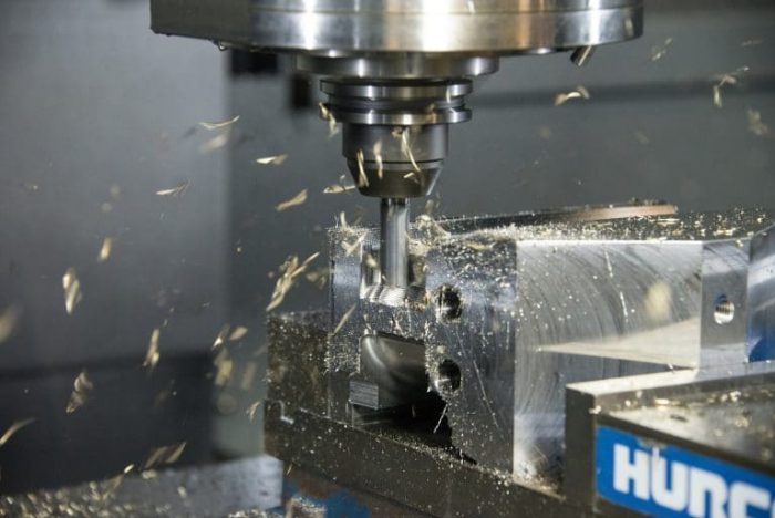

Mastercam’s Dynamic Motion engine is material-aware, constantly adjusting the vector of the cutter path to maintain a consistent chip size. (Provided by CNC Software Inc.)

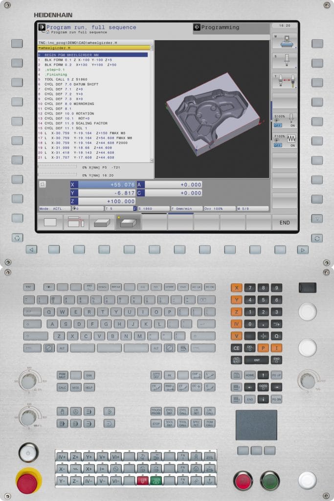

Fast, accurate machine controls such as the Heidenhain TNC 640 shown here are a prerequisite for any successful moldmaking endeavor. (Provided by Heidenhain)

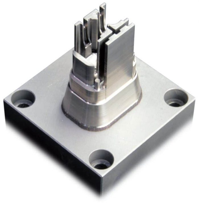

This insert came off a LUMEX hybrid machine basically ready for assembly into a production mold. (Provided by Matsuura)

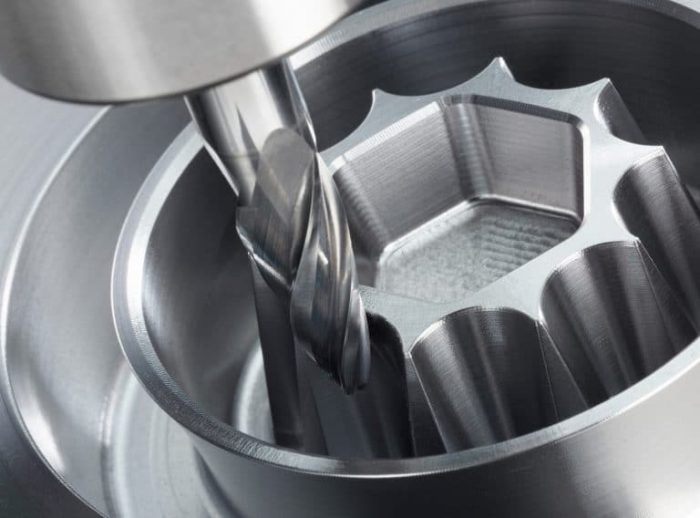

Emuge Circle Segment end mills, also known as conical barrel cutters, feature unique forms with large radii in the cutting area of the mills, allowing a larger axial DOC during pre-finishing and finishing operations. (Provided by Emuge)
“There is a significant abrasion factor when working in a powder bed environment, as well as some thermal considerations, but this is why there’s been such a high level of collaboration between our two companies,” he said.
