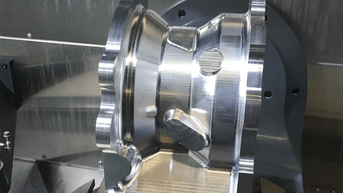

A Quick Drive case gets surface finished.

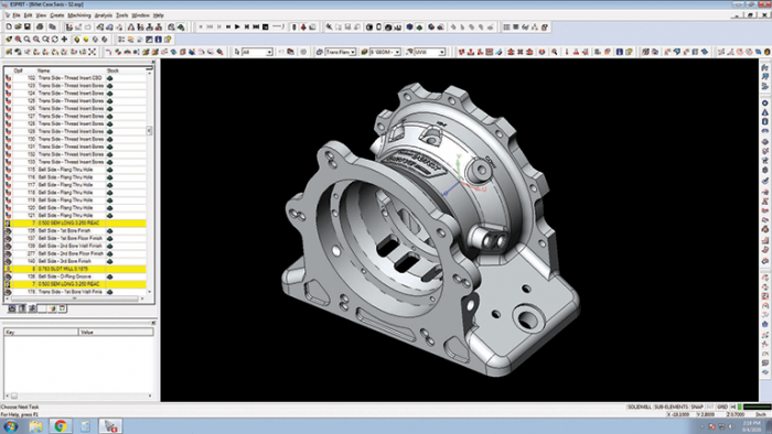

But shifting to internal programming meant choosing a CAM software to keep up with the shop’s brisk pace. “After shopping many of the CAM options available, we decided to go with ESPRIT,” Graves said. What was the deciding factor? “ESPRIT could offer us proven post processors generated by their team of experts to work directly with our specific machines. And the simulation capabilities were like nothing else existing in the industry,” Graves said. ESPRIT is developed by DP Technology Corp., Camarillo, Calif.

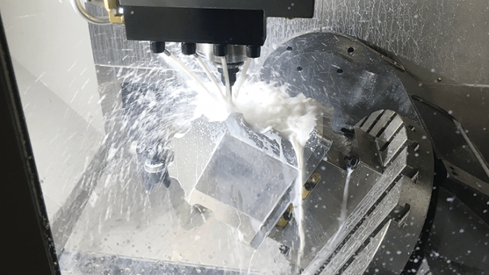

The sheer breadth of components manufactured by Quick Drive is one element of its success. “We build drive units, torque converters, and specialty pneumatic products for drag racing, monster trucks, tractor pullers, drag boats, land speed vehicles, and various high-end custom vehicles,” said Graves. “Our drive unit is composed of more than 20 individual components. The most complex part is a full-billet aluminum case that starts life as a 113-lb [51.26-kg] cube. It gets machined down to around 11 lb [4.99 kg] over the course of about 27 hours of five-axis machine time. Our converters are made from 6061 aluminum and use a combination of ProfitMilling, trochoidal channel roughing, and the five-axis impeller strategy to complete,” Graves said.

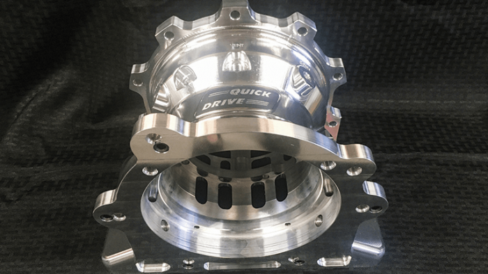

The finished Quick Drive case awaiting fitting placement.

The team at Quick Drive kicked off its ESPRIT license with the shop’s five-axis Haas UMC. For Graves’s team, ESPRIT’s extensive, custom support helped offset the challenges of learning a new software—and that support continued as the business grew. “As we added new machines, ESPRIT upgraded our software to cover the complex parts we needed to produce on new equipment we brought in,” said Graves. “Post-processing support, the digital machine package, and assistance was there again to help us through the growth curve very quickly. We like knowing that the posts are created by ESPRIT for ESPRIT. We don’t have to work with a third party to have the posts created or modified for our equipment.”
A finished Quick Drive billet case.
