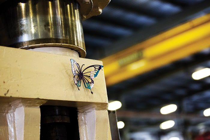

Butterflies, signifying hope, are cut to support Viocity’s nonprofit organization, Hope in the Air.

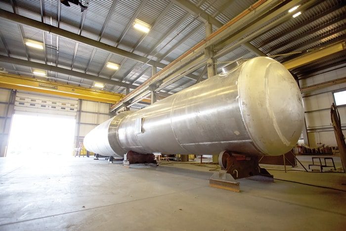

At the same time, managers knew they couldn’t lay out a traditional fabrication and assembly line. This goes back to the level-loading problem. A particular pressure vessel might take a long time to weld, while the structural platform behind it could take half as long.
To overcome this problem, they went with a lane-based layout, essentially a four-lane highway with a large aisle that cuts across the four lanes—giving projects a “passing lane” of sorts. The layout allows projects to flow from one end of the plant to the other at their own pace. If a project in one lane undergoes a time-consuming manufacturing step, projects behind it move across to another lane.

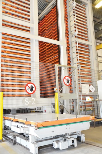

Before the highway starts, plasma cutting tables, press brakes, and other equipment near the receiving dock are dedicated to parts fabrication that feed the main assembly lines. Also near the dock are material storage towers for plates and shapes (like tubes and angles), effectively making most of H&S’s raw stock inventory immediately retrievable at the push of a button. After all, it’s difficult to attain good flow if workers spend hours hunting for specific pieces of raw stock.

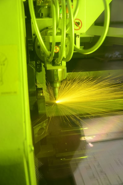

Within a smaller facility adjacent to the main plant, the company installed a TRUMPF laser complete with material handling storage towers and offloading automation, an investment tailored for production fabrication work for OEMs and similar customers. The thinking here: Industrial fabrication involves project-based work, which makes for “lumpy” work flow and challenges with capacity planning. Most jobs are one-off projects, and busy times require a lot of people working together to get fabrications out the door and installed at the job site.

That said, Viocity isn’t just an industrial fabricator anymore. Installed in the Nitro Cutting facility, the TRUMPF 4-kW tube laser can accept round tubes with outside diameters up to 10 in. and up to 3/8-in.-thick walls, depending on the material grade. It also has integrated flow drilling (which creates and heats the hole perimeter to form an extrusion that accepts threads) and tapping.
The system has a 30-ft. infeed and 20-ft. outfeed, enough to handle very long tubes, which was intentional. Not only will the tube laser help Viocity enter new markets, it will help the people at H&S think differently about certain fabrications. The tube laser’s beveling capability has helped reduce weld prep for pipe fabrications. And tab-and-slot, self-fixturing tubular assemblies are now finding their way to the production lanes of the main H&S plant, helping accelerate projects toward the (real and metaphorical) finish line.

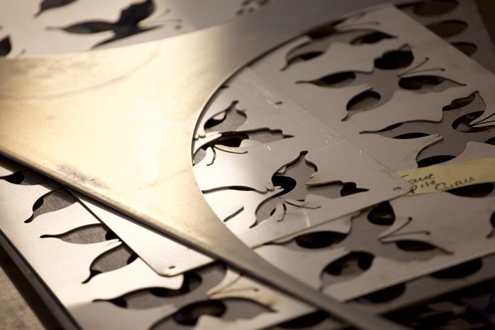

It began several years ago with some internal projects, shortly after the company installed its first laser. Operators began cutting butterflies—just something whimsical for home gardens.
“What began as an internal project transformed into community involvement,” said Sasha Wawrzyniak, Viocity’s general manager. “We began producing a limited number of custom butterflies for a local hospice and community care organization, which it sells for a 100 percent profit at a Labor Day auction and throughout the year. It’s typically around 400 butterflies, which we donate to them.”

Viocity installed material storage towers for its flat sheet, plate, and shape (tube, angle, etc.) inventory.

Machines don butterflies, the symbol for Viocity’s nonprofit organization, Hope in the Air, which supports local causes.

A large vessel nears completion, staged in one “lane” on H&S’s shop floor.
