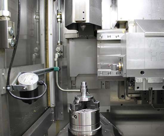

Ingersoll’s star-shaped Chip-Surfer milling cutter enabled Weasler to mill splines in PTO shafts in a single pass with a single chucking.
Chip-Surfer star cutter mills splines in PTO shafts on Mori NTX 2000 multitasking machine
Despite a high material removal rate, the Chip-Surfer star cutter lasts through 2,250 pieces.
