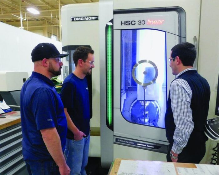

Moeller Precision Tool engineering personnel view machining of a small die punch on the five-axis, high-speed DMG Mori HSC-30 machining center, with programming by Tebis software. (All images provided by Moeller Precision Tool)

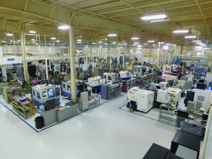

Moeller Precision Tool has the latest technology for manufacturing precision tooling for the stamping and forming industries in its 100,000-sq-ft (9,290-sq-m) facility.

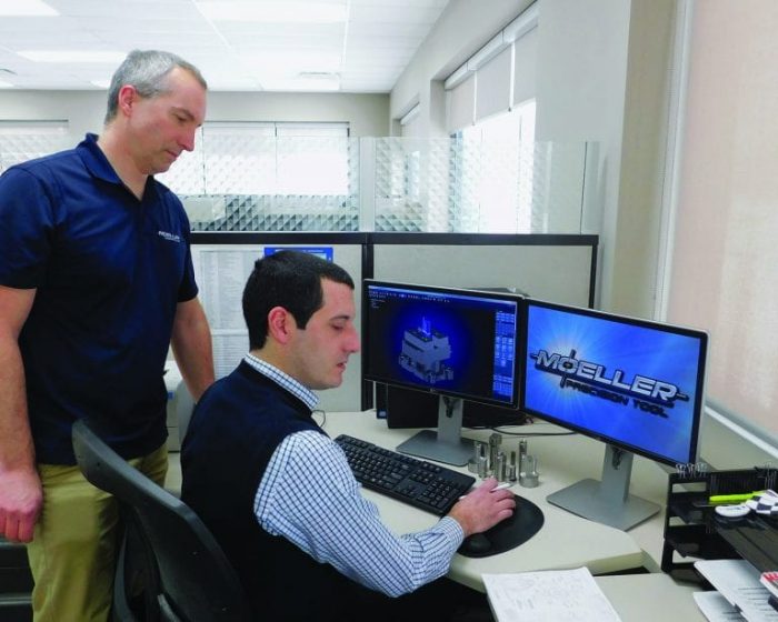

Josh Clayton (left) and Jimmie Colfesh, Moeller Precision Tool programming engineers, collaborate on Tebis software while reviewing a project for the DMG Mori HSC-30.
