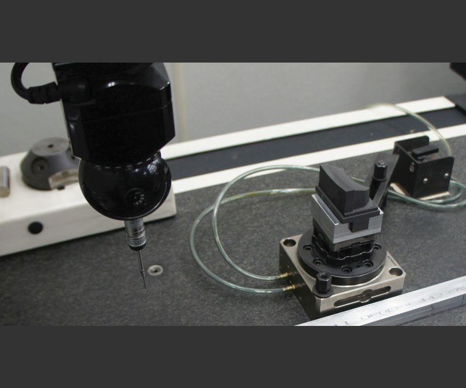

The System 3R-based tooling extends standardization and control beyond machines directly tended by the robot. For example, manually loading the shop-floor CMM (coordinate measuring machine) is fast and easy enough that every part, including all electrodes, can be inspected without affecting the shop’s average three- to four-week lead times. Fast, repeatable setups also make it viable to remove parts from the pallets on manually loaded wire EDM machines rather than the cruder sawing process. In addition to being more precise, the EDM can eliminate an extra setup when geometry must be wire-cut into the mounting face of a part anyway. Even the Grob must be loaded manually with the largest mold bases and base plates because the robot’s weight limit is 110 pounds. Nonetheless, a common workholding interface keeps it integrated with the shop’s manufacturing system.

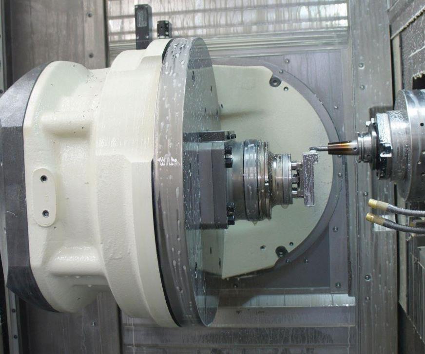

Machining scaled up along with workholding, both in terms of size and sophistication, Mr. Arbic says. The first major change was from a three-axis VMC to one with a two-axis rotary table that enabled 3+2 machining. This eliminated the need for manual setup adjustments to provide spindle access to multiple part faces. However, he says that machine’s rotary table, spindle housing and other components left no room for larger parts like mold bases and base plates, particularly when mounted on pallet stacks. The model in place now, Grob’s G350, suffers no such restrictions, offering the ability to accommodate blocks even larger than the 18-by-18-by-3-inch plates for the largest, standard quick-change frames. With an auto-opening door, a feature requested by Omega and incorporated by Grob, the machine can also be integrated with the robot. That’s a contrast with previous models that required human operators to swap pallets in and out of the table chuck.
The machine’s spacious workzone is thanks largely to its horizontal spindle, which retracts back into the enclosure (including for toolchanges), as well as its one-sided trunnion table, which can flip a full 180 degrees. These two features allow the shop to machine mold base waterlines as deep as 22 inches by drilling to half depth, then flipping the part to bore the rest of the hole from the other side, Mr. Arbic says. Along with carefully programmed 3+2 machining routines, this configuration also makes complex features more accessible than ever before, he adds. That facilitates the use of shorter, more rigid tool assemblies to achieve tighter tolerances and smoother finishes. The machines’ 202-tool-capacity automatic toolchanger (ATC) also prevents tool availability or breakage from limiting lights-out capacity. He adds that the combination of a 26,000-rpm, HSK63A spindle and 63 Nm of torque provide versatility for both heavy material removal and fine finishing operations.
Grob and Grob dealer Merrifield Machinery Solutions (Pontiac, Michigan) deserve much of the credit for getting the machine up and running in the way the shop prefers, Mr. Arbic says. For instance, few users request smooth worktables with nothing but a specific chuck style (a choice that provides a mild chip evacuation advantage while also evidencing the shop’s confidence in its manufacturing strategy). Another example was the addition of a pneumatic amplification system at the back of the machine, a project that also involved consultations with System 3R representatives. Pictured in the slideshow at the top of the article, this system boosts the locking force of the System 3R MacroMagnum automatic table chuck to its maximum. That wouldn’t have been possible with standard shop air.

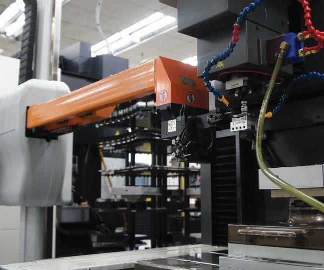

Omega’s System 3R Workmaster carousel robot loads a pallet-mounted, pre-referenced electrode into a Mitsubishi EA-12V ram EDM unit. The workpiece on the table interfaces with the System 3R fixturing system via a custom sub-pallet.

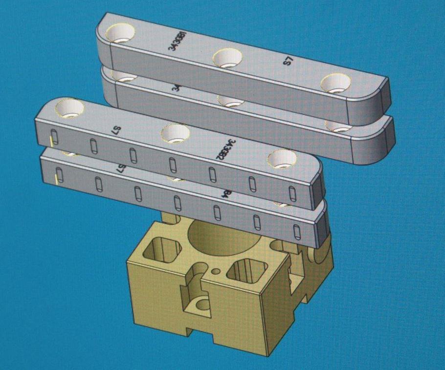

All parts are modeled in CAD/CAM software along with representations of the pallet, and all references are calculated according to the geometry of a custom tooling ball. In this case, Omega is making the most of its material by machining multiple gibs (components for mold slide assemblies) from the same block. The pallet shown here is a 54-mm model from System 3R.
The Grob G350’s horizontal, retractable spindle and single-sided, 180-degree trunnion ensure a spacious workzone. Its 202-position toolchanger is loaded with a standardized selection of cutters, all of which are guaranteed within 10 microns, mounted in shrink-fit holders and tied to material-specific parameter settings within the shop’s CAM software tool library. Specifiying the table without T slots evidences Omega’s commitment to eliminating process variation.

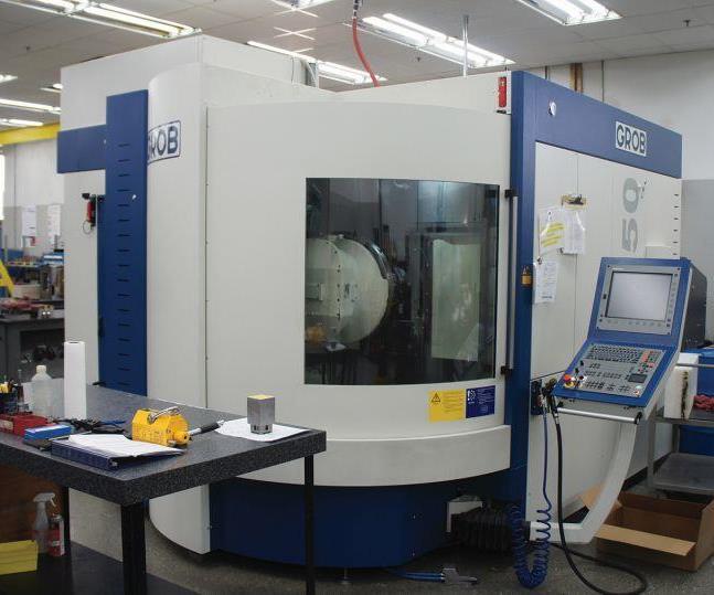

Omega has two Grob G350 five-axis machining centers. The second was outfitted for automation, but this one, the shop’s first, isn’t tended by the robot. Still, System 3R fixturing keeps the machine integrated with Omega’s standardized manufacturing system.

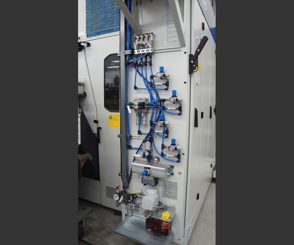

This air-amplification system on the back of the G350 machine ensures the System 3R chuck securely clamps even the largest parts. Air supply is controlled by the robot, and various safety mechanisms ensure the chuck stays clamped in the event of a power outage or other unexpected loss of air pressure.
Precisely repeatable fixturing enables seamlessly incorporating machines not tended by the robot into the process flow, including wire EDM units and, as shown here, the toolroom CMM.

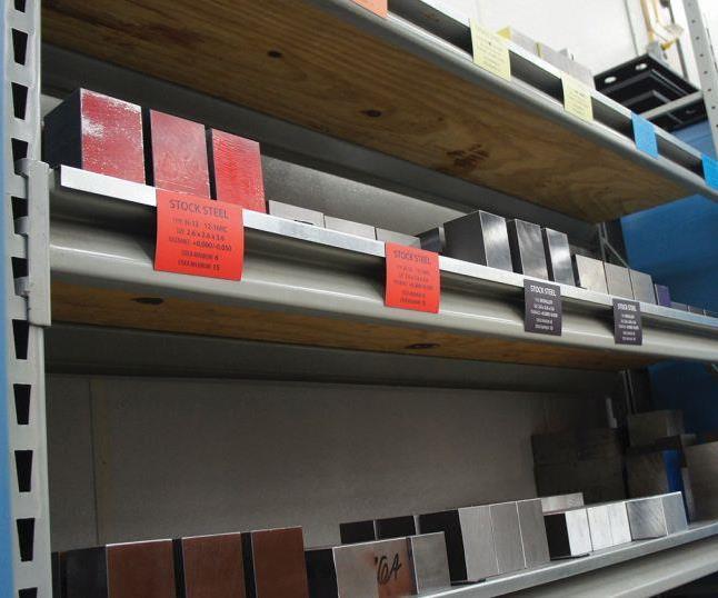

Stored by material type in horizontal and vertical configurations, standard-size blocks of raw stock with connecting hole patterns already machined ensure easy, fast pallet mounting at the outset of any job.
