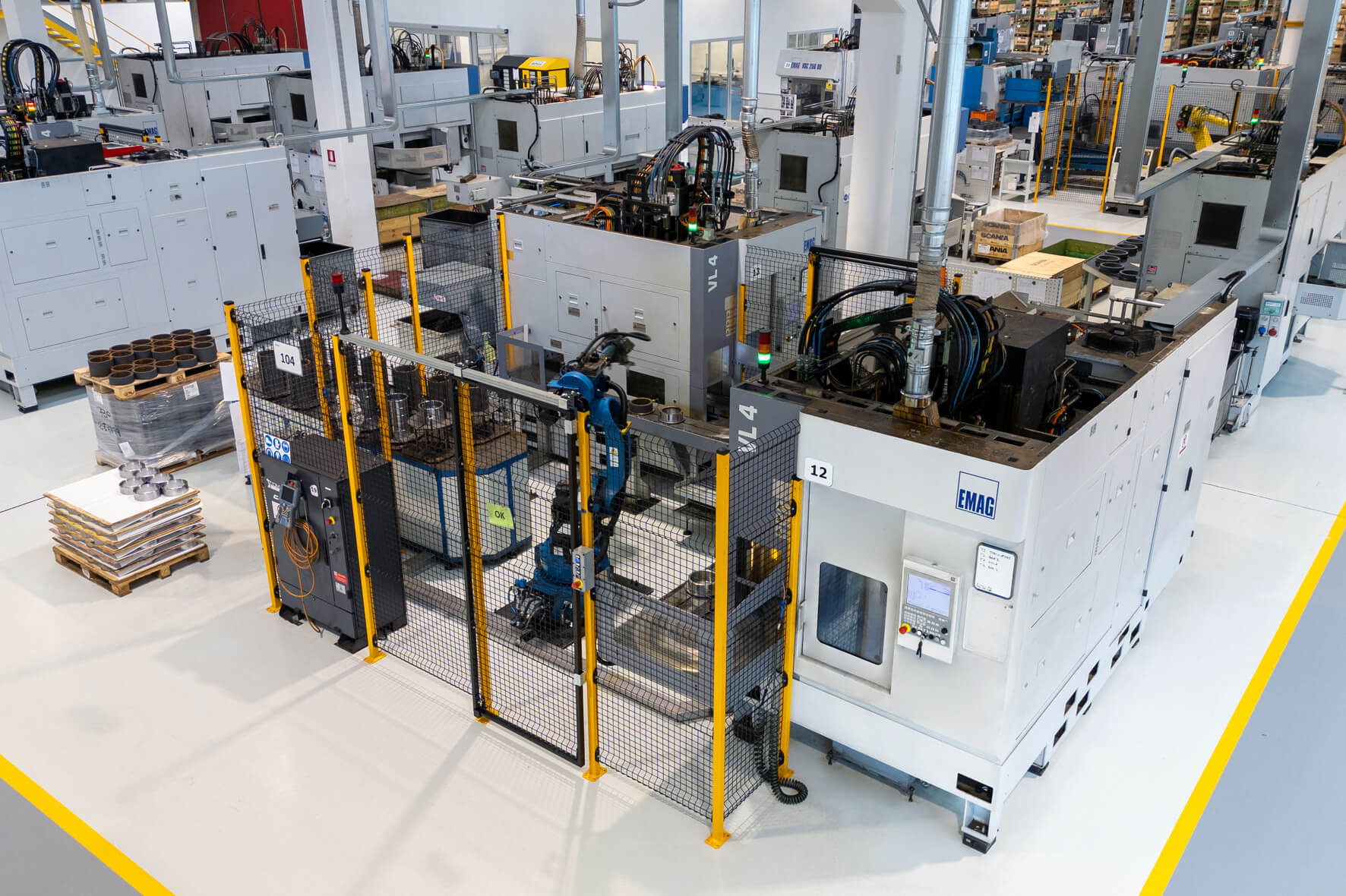

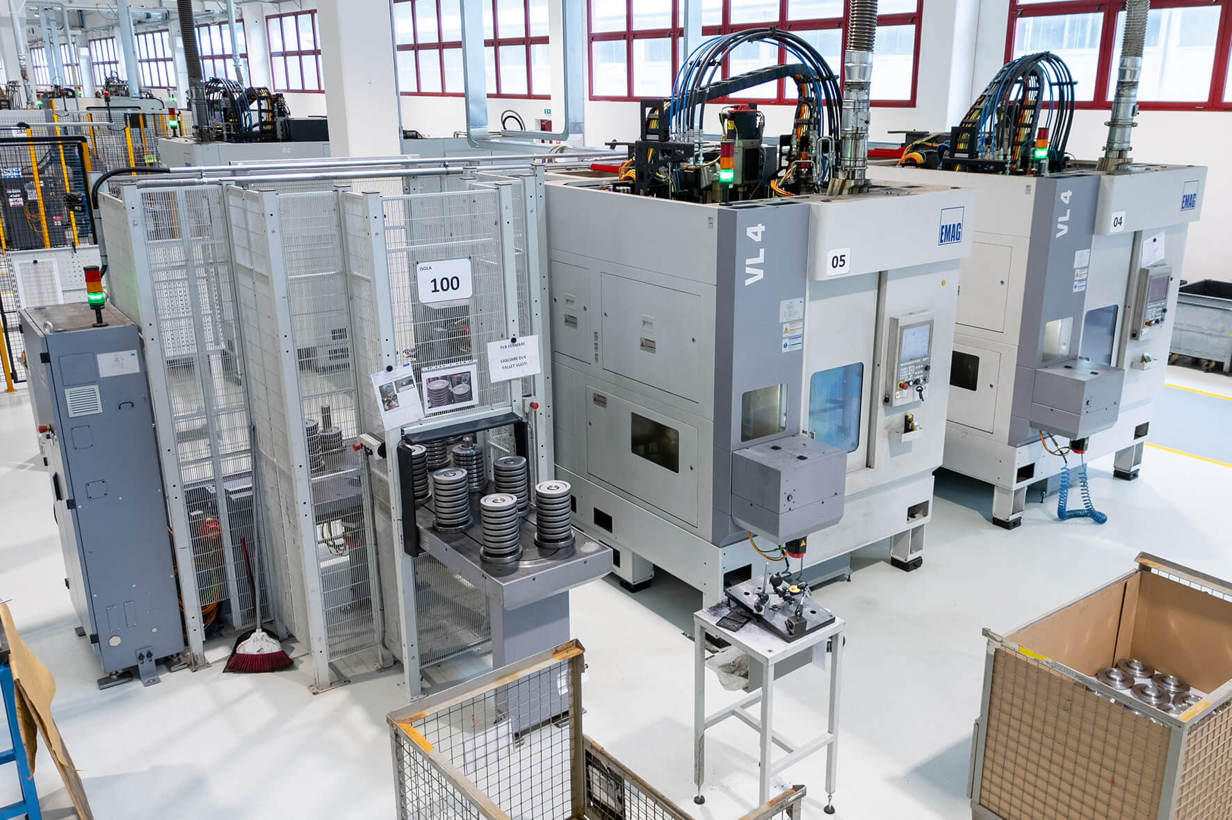

The company uses various manufacturing systems from EMAG to meet the different production requirements of its customers. “In one of our production lines, we work with VL 7 machines, where the operator manually places the workpieces on the automation belt,” explains Reguzzo. “In other production lines, we work with VL 4 machines that are equipped with TrackMotion automation. Here, the automation is very fast and we have greater autonomy, so we can also run the machines in unmanned mode.” There are also other manufacturing systems, also VL 4 and VL 6, which are automated with robots. The decision was made to use a system with robots here, as many components have to undergo other operations in addition to turning, such as marking, which can be carried out very easily and flexibly with the robot.
One of the production lines at MR Components with VL 4 machines equipped with TrackMotion automation. This enables unmanned operation in the evening hours.

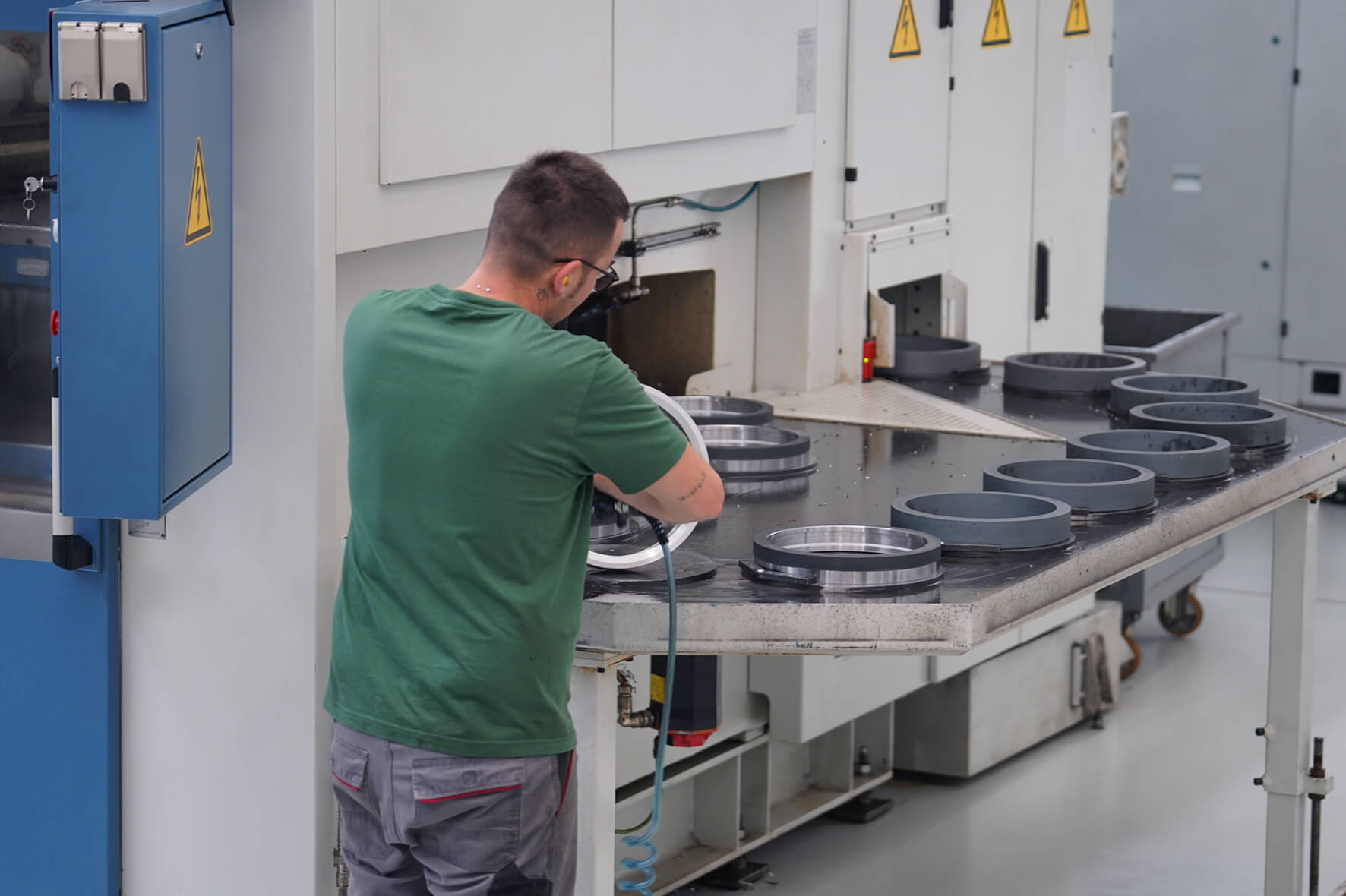

In one of our lines, we work with VL 7 machines, where the operator manually places the workpieces on the automation belt. This process has proven to be particularly effective for very simple workpieces or more complex workpieces with small quantities.
In other production lines, we work with VL 4 machines that are equipped with TrackMotion automation. The automation here is very fast and we have greater autonomy, so we can also run the machines in unmanned operation. We work in two shifts and let the machines continue to run autonomously for 2 to 4 hours in the evening, depending on the storage capacity of the raw and finished parts.
We have other manufacturing systems, also with VL 4 and VL 6 machines, which are automated using robots. The decision was made to use a system with robots here, as many components have to undergo other operations in addition to turning, such as marking, which we can carry out very easily and flexibly with the robot.

Does this system allow you to utilize production time even during company closing times, so that the machines continue to run for 2 to 4 hours, depending on the workpiece, while you and your employees are already going home?
Yes, exactly. I have the certainty that if I check all components 100 percent, the machine will automatically stop production if a part is faulty. That way I avoid rejects and make optimum use of production time. That’s a big advantage, because nowadays it’s really difficult to find staff for the night shift. In this way, we have found a way to do without the critical night shift and still benefit from the extra production hours – that’s why we call this time “free” hours.
