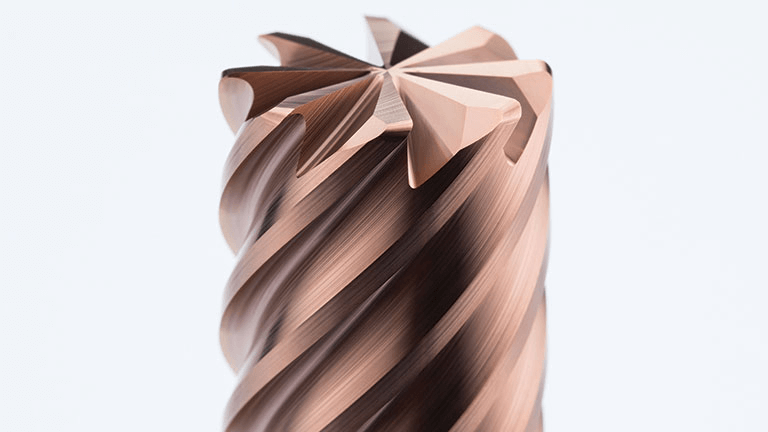

Coolant flows to the workpiece through GWS’ 15-flute end mill.

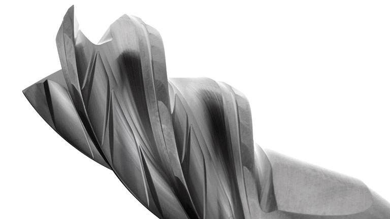

Unequal flute spacing in OSG’s variable geometry end mill line is designed to reduce vibration during machining by altering the timing of each flute engaging in the workpiece.

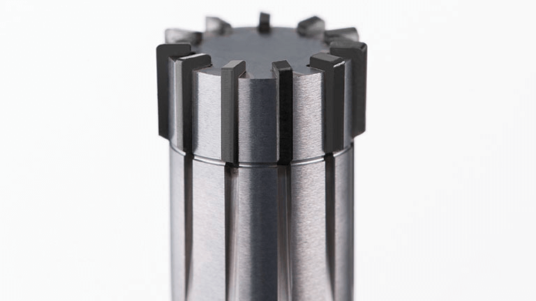

Horn’s multi-flute, diamond-tipped end mill is for milling sintered carbide and non-ferrous materials.

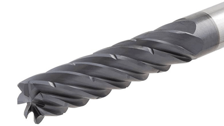

The cutting edge in this Iscar end mill is designed to help split chips.
