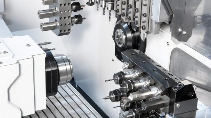

Part of this training centers around different kinds of tooling. Here again, significant differences exist between the cutting tools and toolholders used on a Swiss machine and those of a conventional, turret-style CNC lathe, never mind the fact that many of the former are as much milling machine as they are lathe. Determining what works and what doesn’t requires that programmers and operators have the time needed to experiment with smaller, sharper Swiss-style turning inserts as well as end mills and other rotary cutters that might be less familiar to a lathe machinist.
It’s for this reason that Judt and others interviewed for this article agreed that it’s a good idea to lean on the machine distributor’s applications engineers for advice—especially when just getting started—and always keep the front door open to knowledgeable cutting tool salespeople. “Yes, you should be selective on how many hours you spend each month evaluating new tooling, but at the same time, it pays to be aware of what’s out there and how to best apply it,“ he said.
With eight axes and 27 tools, the Nexturn PYII can machine a variety of complex parts in a single operation.
One of the things these folks might suggest is quick-change tooling. Derek Briggs, Swiss product manager for Tsugami/Rem Sales LLC, Windsor, Conn., noted that changeover time is a killer for many shops. The best way to combat it is to invest in a system that provides for offline measurement and allows individual tools or even an entire gang plate to be swapped out in seconds.
“For shops that are running high production volumes, quick-change eliminates the need to reach into the machine, where quarters are typically tight,” he said. “And for lower-volume shops that may be setting up several jobs a day, quick-change is even more crucial. You can get all of your tools ready, undo one screw, replace the toolholder or live-tool assembly, and move on to the next tool in the setup. In either environment, it’s a huge timesaver.”

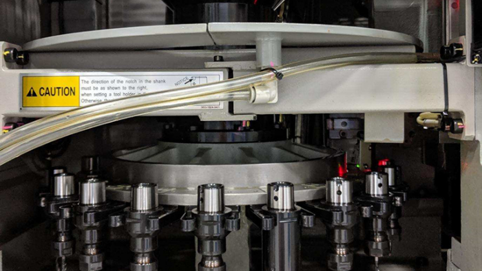

Another novel option—at least for some Swiss models—is an automatic tool changer (ATC), a feature that brings these machines into larger, fixed-headstock multitasking lathe territory. Miller noted that, while Swiss-style machines are typically generous in terms of fixed tool stations, operators often find themselves short on rotary tools. Citizen has solved this problem by offering a 13-tool ATC option for its L20-XII B-axis machines that “can be added many years later,” Miller said. Several other machine builders offer similar options, at least some of which can be installed in the field.

Machining-center-style tool changers are becoming more common on Swiss-style CNC lathes, as seen in this Tsugami SS38MH-5AX from Rem Sales.
“Shops need to think outside the box when they enter Swiss territory,” he said. “We see customers every day that are making bone plates and other non-round parts on machines like our Tsugami SS38MH-5AX. You can run square or hex stock, extruded materials, and because most machine builders now offer convertible spindles—where the machine can be used as a chucker—you can also load sawed and cold-headed blanks. The point here is that, unlike previous generations of Swiss-style lathes, not everything has to be machined from a twelve-foot bar of round stock.”

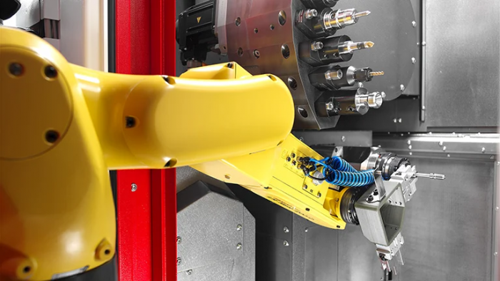

The convertible main spindles that are now practically standard equipment on Swiss-style CNCs raise another possibility beyond the chucking of larger parts. They also open the door to robotic part handling, something that most experts agree is on the rise with Swiss-style and conventional turning machines alike. One example of this comes from Index Corp., Noblesville, Ind., where Proposals Engineer Randy Carlisle has been kept busy of late writing proposals for the company’s recently introduced iXcenter integrated robot cell.
The Star Monitoring & Operator Support System (SMOOSS-i) is a web-based application that allows users to remotely monitor machine status, part count, production rate and history via smartphone, tablet or PC.
Carlisle said the self-contained system is equipped with a six-axis robot, custom end-of-arm tooling, and palletized part storage. It is designed for the loading and unloading of Index’s TNL-series machines, he explained, but can also be used in conjunction with a CMM or comparator-style gaging. “It allows you to pull a workpiece out of the spindle, place it into a Renishaw Equator, for example, inspect it, and either place it into a tray or call for an operator if there’s a problem.”

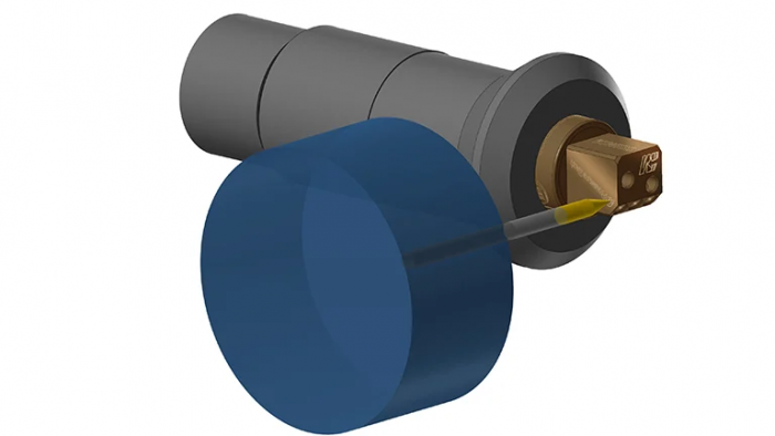

CAM software, he explained, supports wireframe and solid part models. It offers tooling libraries, turning and milling strategies, and it simplifies one of the more challenging aspects of Swiss-style programming—the synchronization and superimposition functions mentioned at the start of this article, functions that are responsible for a Swiss-style CNC’s ability to produce parts three to four times faster than conventional lathes.
As for the programming itself, Leclerc suggested it’s not all that difficult, even for those who’ve been programming two-axis lathes for decades. “In a CAM system, you program a Swiss machine exactly like you’ve been programming your other lathes and machining centers. The software takes care of switching the axis directions, the G and M codes, the wait commands, the turning, drilling, and milling operations, and it shows you how it’s all going to work in the machine. When everything is the way you want it, the post-processor stitches it all together and generates accurate G-code. That’s all there is to it.”
