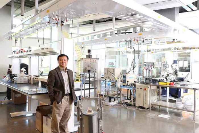

Professor Xiaochun Li and his team spent years uncovering ways to uniformly self-disperse nanoparticles in molten metal. Photo courtesy of Oszie Tarula, UCLA.

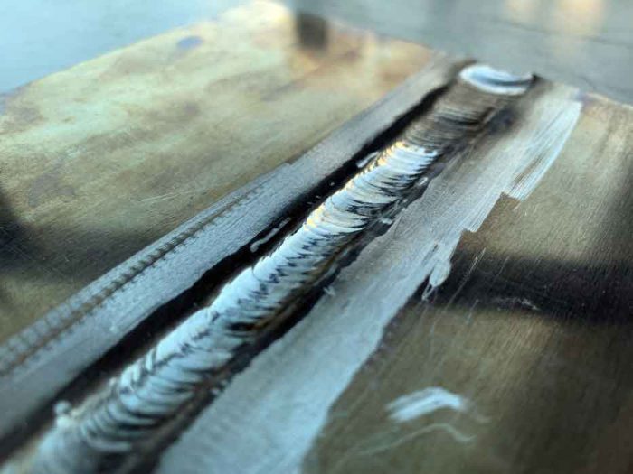

Two pieces of aluminum 7075 are welded together with a nanoparticle-infused filler wire. Photo courtesy of Oszie Tarula, UCLA.

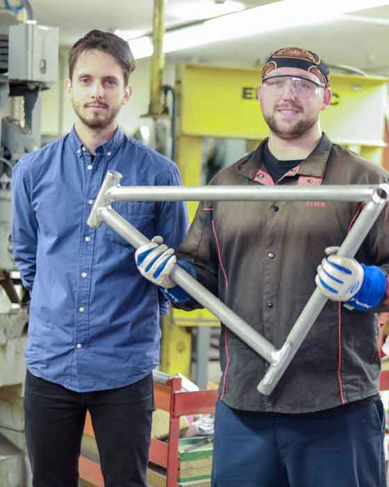

UCLA Samueli School of Engineering lab technician Travis Widick holds a bike frame welded using aluminum alloy 7075 with graduate student Maximilian Sokoluk. Photo courtesy of Oszie Tarula, UCLA.

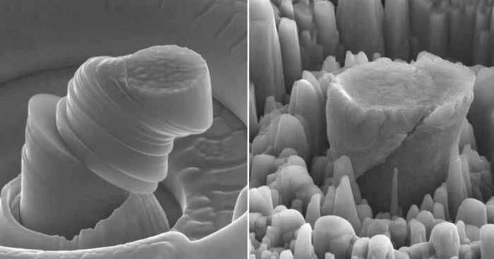

Images from a scanning electron microscope show a material’s postprocessing morphology without (left) and with nanoparticles. Photo courtesy of Oszie Tarula, UCLA.
