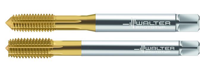

The new threading tool from Walter, the TC410 Advance HSS-E can be used universally for blind and through-hole threads in most materials.
Waukesha, WI—Walter has introduced the TC410 Advance HSS-E thread former, a versatile new TiN coated threading tool that’s cost-effective even for small and medium batch sizes. It can be used universally for blind and through-hole threads in most materials having a primary application in ISO material groups P, M and N and ISO K and S as a secondary application.
Key advantages for using the TC410 Advance thread former are superior performance, reduced torque and longer tool life thanks to new geometry and a post-treatment after the coating process. The post-treatment provides an extremely smooth surface on the tool. Having a smooth surface reduces friction between the tool and the workpiece and consequently the amount of heat generated. Minimizing the production of heat reduces wear and thus increases the useful life of the tool.
Walter offers the new TC410 Advance in two variants: With lubrication grooves for applications that need help getting coolant to the area where the forming is happening or without lubrication grooves for when the coolant is already pooled in the hole. Deeper threads up to 3.5 × DN can be produced in certain materials with these tools. Also offered are a wide variety of configurations covering thread styles, thread tolerances and shank standards, including an option for LH threads.
WAL-372: Walter TC410 thread former
