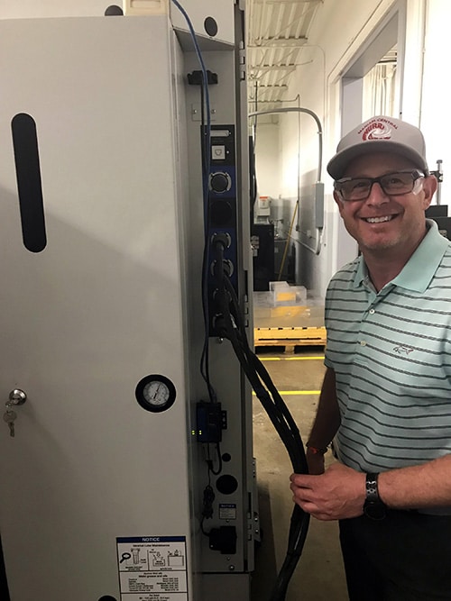

Network capabilities are not for new equipment alone. M-1 Tool Works Project Manager Rusty Thielsen shows how a “Moxa box” connector (signaling green above) can connect legacy equipment to the shop’s DNC system. (Provided by M-1 Tool Works)

Every time M-1 adds new equipment, the company adds it to its Cimco network. Cimco supports numerous controls including FANUC, Haas, Mazak, Fagor, and more. Combined with RS-232 communications hardware (“Moxa boxes”), M-1 has hooked up its legacy equipment to Cimco as well. “We are managing larger and more complex programs much faster and more efficiently,” Thielsen said. “Any program changes or adjustments sent back to DNC-MAX can be automatically raised in version or stored in a quarantine area. This keeps a much tighter lid on tracking changes or reverting to previous versions if necessary. Our internal non-conformance is much lower as a result.”

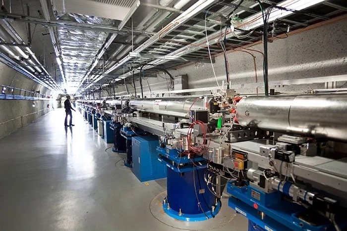

For example, M-1 is part of the team supplying components and assemblies for the Linac Coherent Light Source (LCLS) project at the Argonne National Laboratory (ANL). M-1 machined components are used on the focusing operation on the light beams that create ultra-bright, ultra-short X-ray pulses from a high-energy electron beam. These X-ray pulses are a billion times brighter than the most powerful known light source and are used to capture images of molecules and detail their actions within an atomic structure.

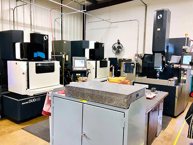

Machining of the metals involved five-axis milling, drilling, amd wire and sinker EDMing. The tight tolerances, all in the range of 0.0005″ (0.0127 mm) or less, were validated in the M-1 quality department using CMMs and other metrology devices. CAD files were supplied to M-1 by the designers at ANL. Particularly difficult machining operations required precise matching and line-up of milled, wire EDMed and sinker EDMed features.
M-1 supplied components to the Linac Coherent Light Source (LCLS), designed to generate X-ray pulses a billion times brighter than the most powerful known light source. It would be the first machine to produce high energy (or “hard”) X-ray laser pulses that would last for just femtoseconds, millionths of a billionth of a second. (Provided by SLAC National Accelerator Laboratory)
According to M-1, it is one of the few shops that had the machinery, people, expertise and experience to do this job to the required specifications. Improved network proficiency and CNC program control contributed to M-1’s entire LCLS work project being produced in just three months, much faster than the normal timeline for such projects, according to the company. In comments made during a recognition presentation, ANL scientists noted the entire system was aligned and successfully fired on just the second effort, thanks to the high quality of M-1’s machined parts.
