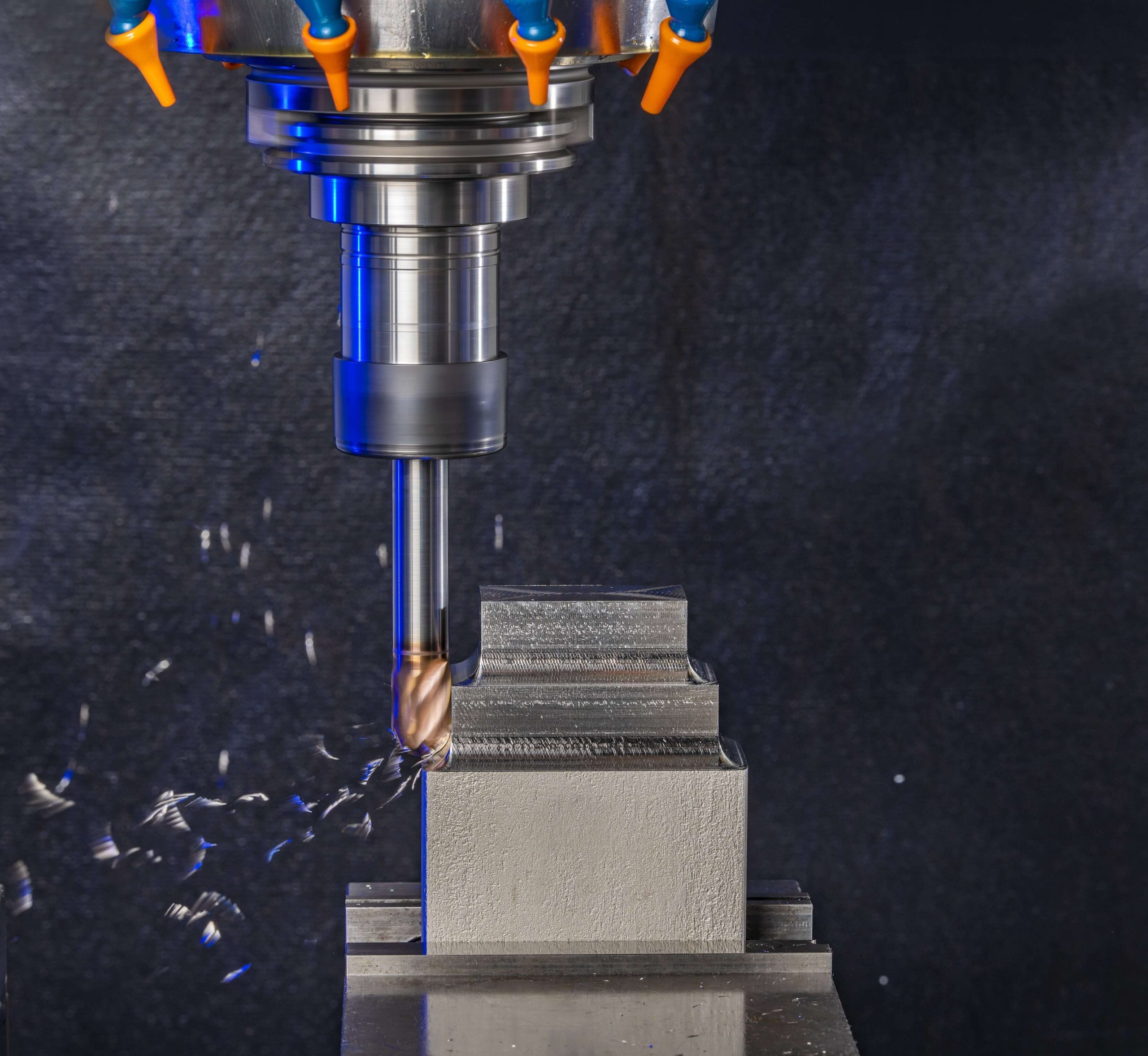

POW-R-ARC A106N (¾ in. dia., 6-flute ball end with neck relief and a 3¾ in. LBS) removes stepdown notches left by a corner radius roughing end mill in 316L stainless steel. This semi-finish pass, machining on the tool’s sidewall and ball nose, removes .020 in. from sidewall and radius with minimal notching. One finish pass with the same tool will yield an excellent finish.

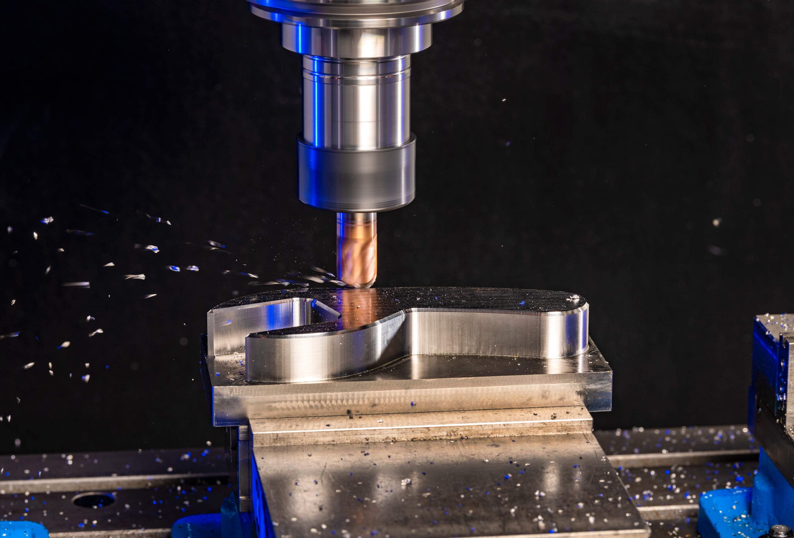

POW-R-ARC A108 (¾ in. dia., 8-flute ball end and 1 in. LOC) machines a .050 in. perimeter chamfer in 6AL-4V titanium. Compared with a 4-flute tool, the POW-R-ARC cutter leaves a bur-free finish at incredible speeds.

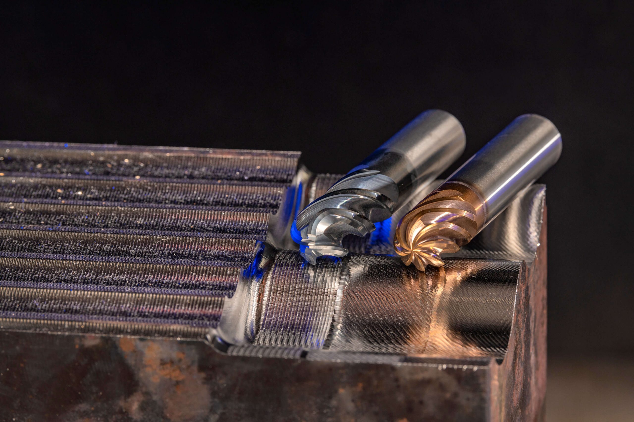

The POW-R-FEED M924B (left, ¾ in. dia., 4-flute ball end, 1 in. LOC) v. the POW-R-ARC A108 (right, ¾ in. dia., 8-flute ball end, 1 in. LOC) Material: A2 at 60 HRc. Using the same stepover value, the new POW-R-ARC 8-flute tool provides a superior 3D contour cut 5x faster, with barely visible ridges (far right) and very little finish work. 4-flute: 36.3 ipm at 2292 rpm POW-R-ARC 8-flute: 215 ipm at 9155 rpm
