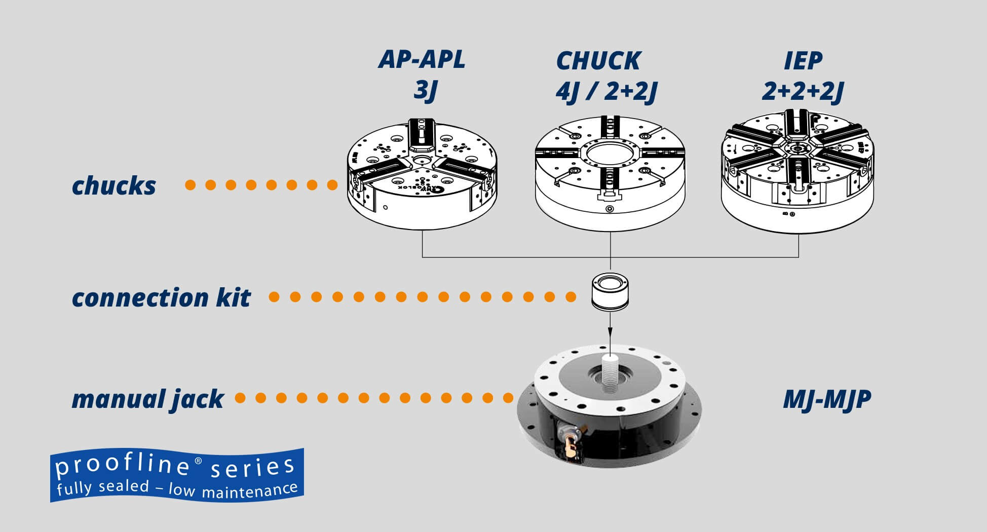

  • Adapted to machining centers to manually operate a power chuck
  • Ideal for 5 axis mill-turn machines without air/oil feed
  • Useful for palletized machines due to mechanical irreversible constant gripping force
  • Ideal alternative to a manual chuck with simple integration of power chucks
  • Operate virtually any type of power chuck: 2/3/4 jaws, 2+2, 6 jaws, 2+2+2 etc.
  • Use with sealed power chucks of the SMW Autoblok Proofline series
  • No need for air/oil feeds making it a perfect solution for pallet changing systems
  • Easily interchangeable among several machines
  • Adaptable to the machine table/pallet with different centering and mounting threads patterns
  • Operate chucks in both external and internal clamping
