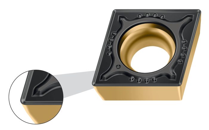

New Walter MP6 Geometry. Inset shows short primary chamfer for stability
To cover the widest possible range of applications, Walter offers the MP6 geometry in CCMT, DCMT, TCMT and VBMT basic shapes. Its short protective chamfer, which is characteristic of roughing inserts, ensures a high strength of cutting edge, even in challenging conditions, for example when machining forged parts or components with interrupted cuts. The 18° positive rake angle ensures excellent chip control during medium machining.
To prevent vibration, for example with thin-walled components, Walter has given the MP6 geometry an open chip breaker groove. This reduces the cutting pressure even when cutting at a higher depth of cut. This also makes the MP6 ideal for unstable workholding setup and components with long overhangs, for example during internal turning. The new Tiger-tec® Gold grades also have a positive impact on tool life. The WPP10G, WPP20G and WPP30G grades are adapted to different operating conditions, thereby improving tool life and performance across a broad range. Walter specifies feeds from 0.004-0.014 in. and depths of cut from 0.016-0.157 in. as the range for the machining parameters.
