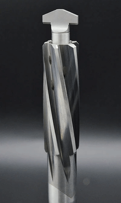

A large brazed-carbide reamer with staggered coolant ports in each flute features an independent rotating plunger designed to detect blind or undersized holes. (Provided by GWS Tool Group)

He also described a large brazed-carbide reamer with staggered coolant ports in each flute. This brazed-carbide reamer features an independent rotating plunger designed to detect blind or undersized holes. It detects these holes by compressing when meeting an obstruction and blocking coolant, which stops the machine prior to the tool breaking.

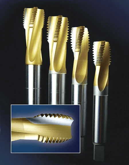

Manufacturers have good options in both roll forming (chipless production of internal threads) and cutting taps. For example, Emuge offers Innoform–Steel-M, a line of HSSE-PM taps for forming threads with improved surface quality, while increasing static and dynamic thread strength, in medium strength steels up to 44 HRC.
Innoform-Steel-M Taps feature polygon geometry for low torque and longer tool life. A special powdered metal substrate and a TiN-66 coating with increased hardness reduce friction and extend tool life. Innoform-Steel-M Taps are recommended for forming cold-extension steels, cementation steels, castings, heat-treatable nitriding and cold work steels, as well as high-alloyed and hot work steels.
When long chips are the challenge, taps are available with cutting face geometry and spiral flute form, which combine to affect chip flow, chip curl and chip length. Emuge chip-breaking technology (Emuge CBTz) produces short, broken, controllable chip formations that eliminate flute clogging and potential failure of the machine tap due to chipped cutting teeth or breakage, according to the company.
The CBTz tap is surface treated with TiN to reduce friction between the tap and workpiece, which results in improved thread finishes and increased tool life in carbon and alloy steels, cast and forged steels, tool and die steels and 300 stainless steel up to 35 HRC.
For short chipping hardened steel and cast iron, Emuge A-H Taps are a new generation of Premium HSS-E and HSSE-PM taps that are especially efficient for tapping abrasive materials and materials with high hardness levels, such as cast iron, common in the heavy equipment and agricultural vehicle markets. Emuge A-H Taps are available with or without coolant through holes and with TiCN coating, or NT nitride surface treatment, for improved tool life.

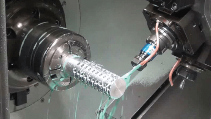

A SynchroFlex II SFT50 performing synchronized tapping with M8 on a CNC lathe with live tooling uses a self-reversing tapping attachment at 2,500 rpm to tap ten M8 holes in 11 seconds. (Provided by Tapmatic)
Lubrication is important for tapping in general and especially for roll form tapping. “Using a tap holder with internal coolant capability allows the use of taps with either an axial coolant hole for blind holes, or radial coolant holes for through hole applications,” said Johnson. “This gets the coolant where it is needed for the cutting or forming of the threads. It also greatly helps with clearing chips out of the hole when using cutting taps.”
Tapmatic’s SynchroFlex tap holders all include a balanced, high-pressure internal coolant system. Pressure up to 80 bar or 1,200 psi can be used and because the system is balanced, the coolant pressure does not influence the tap holders axial compensation.
Self-reversing tapping attachments offer special advantages compared to synchronized tapping. “With synchronized tapping, because the machine spindle needs to stop and reverse within a very limited number of revolutions, it is not possible for the machine to maintain the programmed spindle speed. Using a self-reversing tapping attachment allows the machine spindle to turn continuously in one direction at the actual program speed. The result is a shorter cycle time,” said Johnson.
For example, in one test using rigid tapping to tap ten M8 holes at 2,500 rpm, cycle time was 18 seconds. Repeating the same test at 4,000 rpm saved just one second. Using a self-reversing tapping attachment at 2,500 rpm to tap the same ten M8 holes took just 11 seconds. “In addition to improving cycle time, using a self-reversing tapping attachment also allows the tap to run at the recommended speed, and this provides longer tap life as well,” said Johnson.
